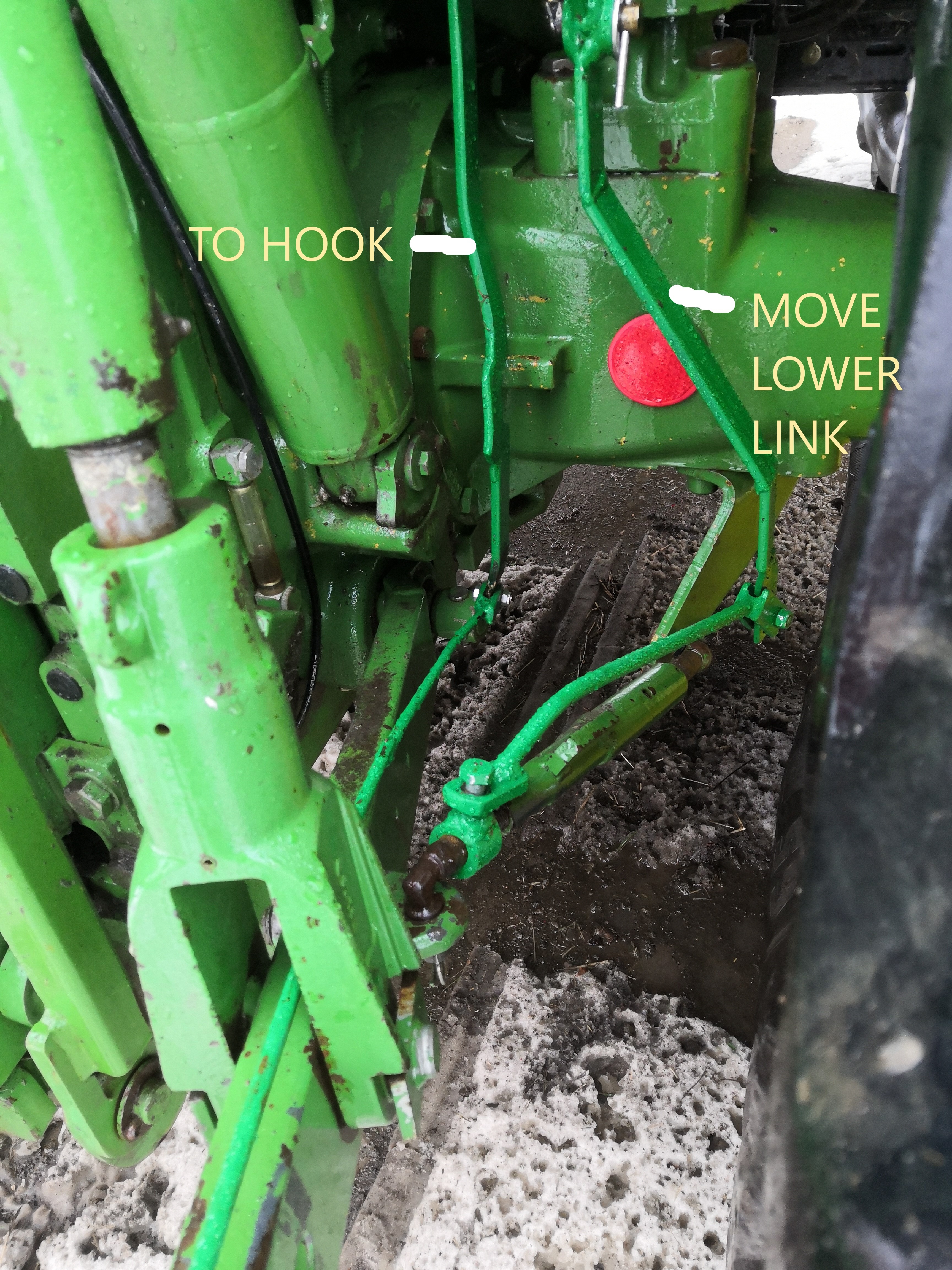

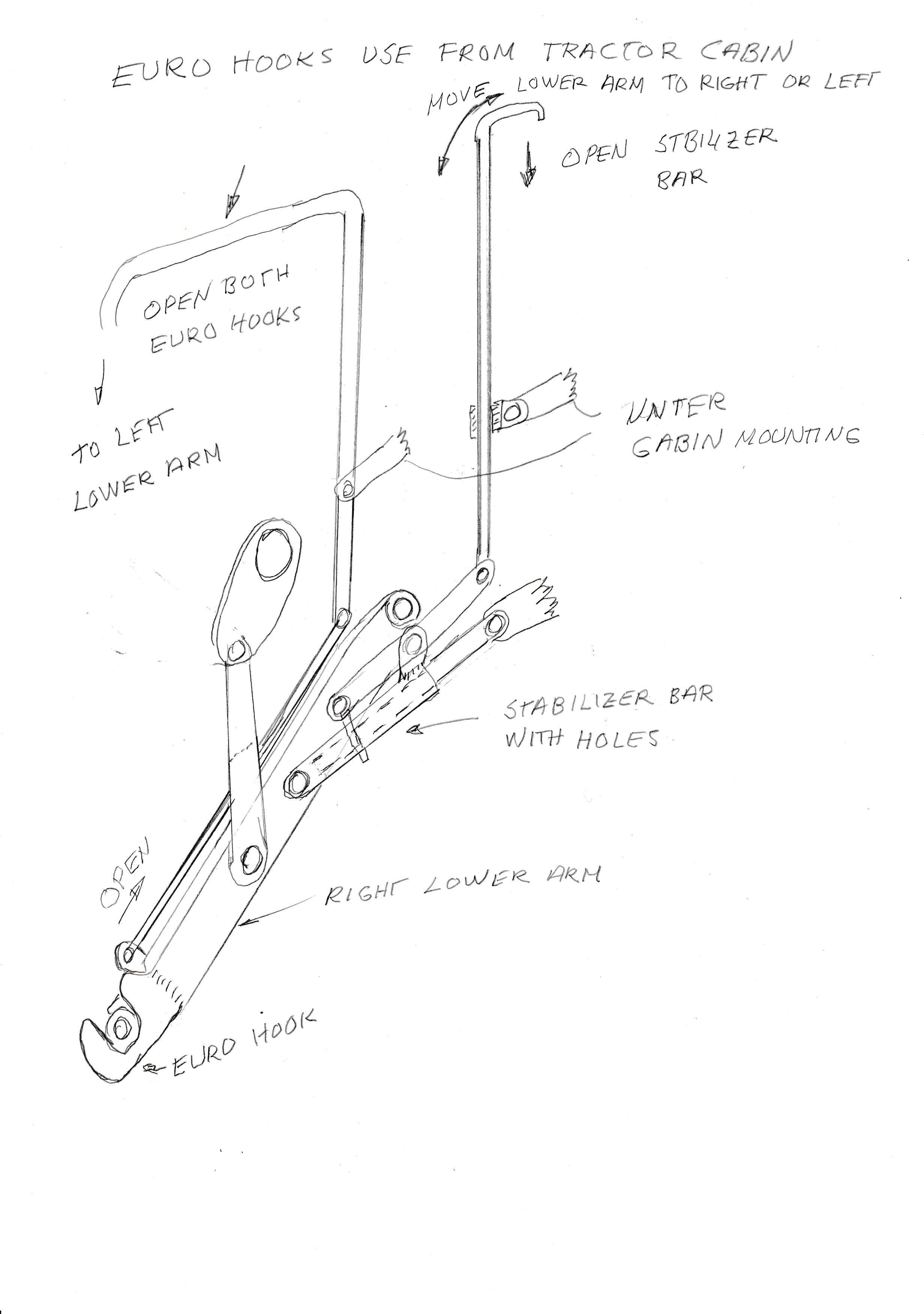

DO IT PLEASANT. Here is one.
You can use EURO HOOKS from the
Tractor cabin with this kind of links.
Brian at Fit Rite maybe could help doing these to you.
By This JD we can open Euro Hooks and widen right lower link from the cabin.
The right stabilizer on JD is unlocked and has a spring to move it with that link. Works well.

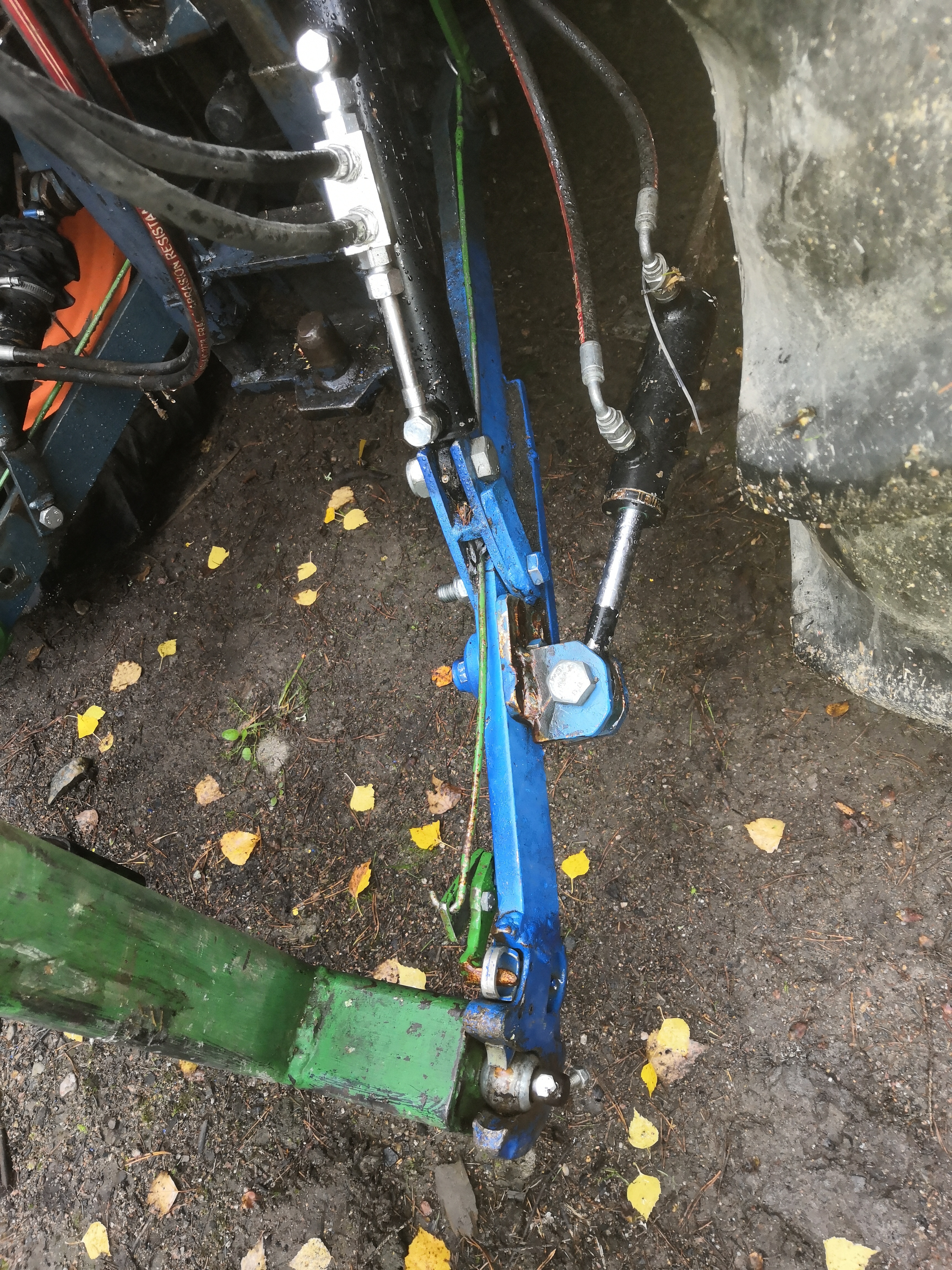

But if the stabilizer bar is locked type then we can open the lock as next.
You can from the cabin open and lock the right stabilizer bar and move the right lower arm easy left or right as you need.
I have in my own Kubota tractor my own made hydraulic stabilizers on both sides. That is good too.

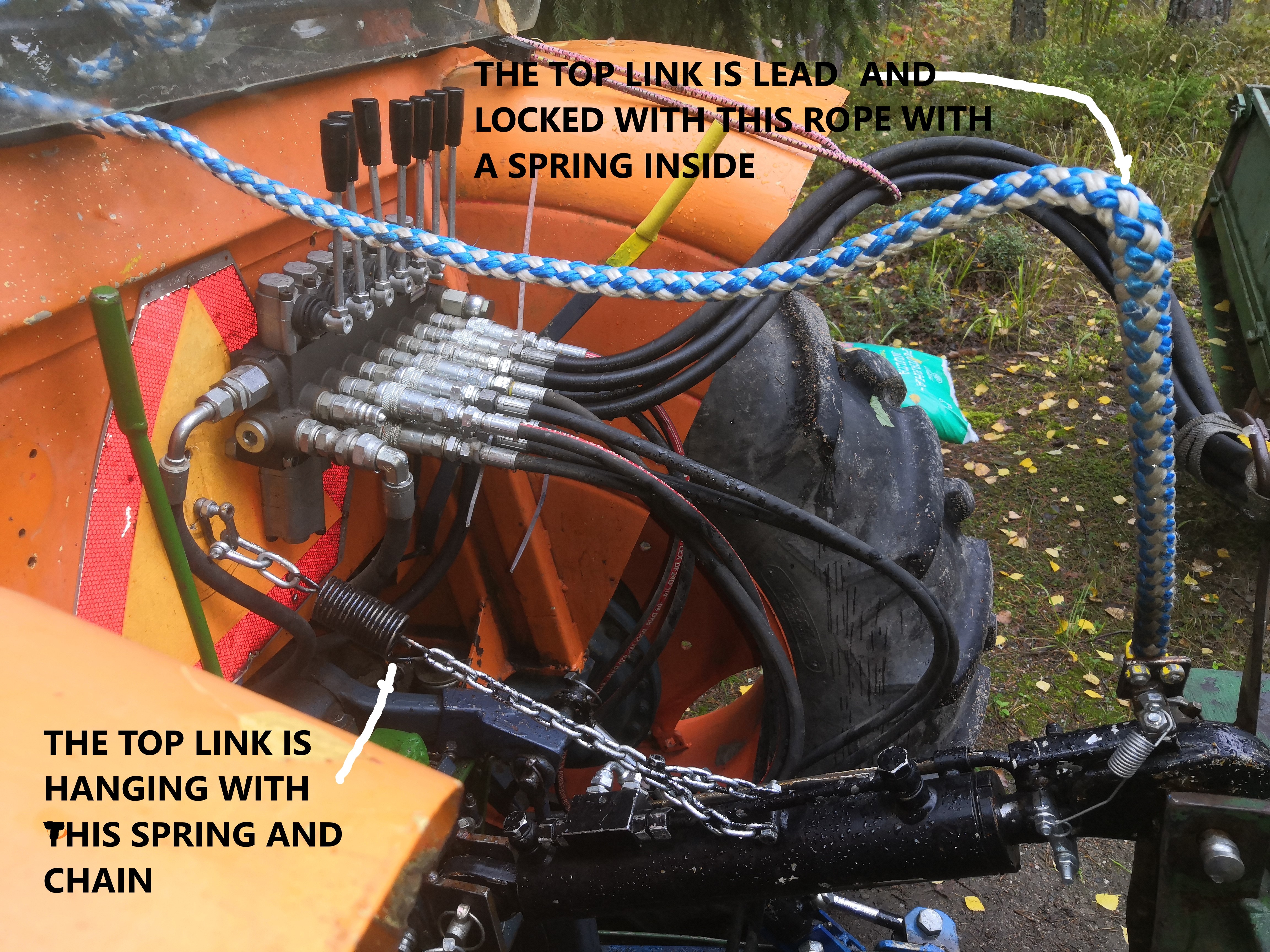

But next they do not have
The use of top link from the cabin.
You need a thick rope and a spring inside it,
one feet long spring is good to keep the rope above.
This is need for biggest tractors.

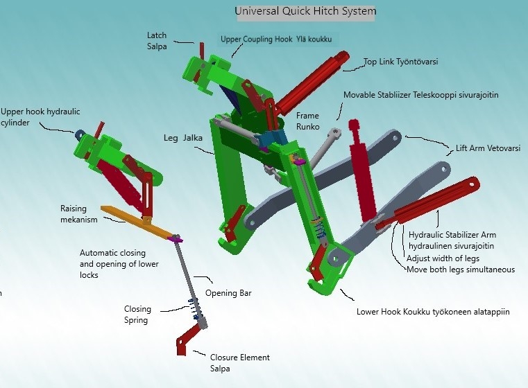

IF you like QH then this was universal QH for all tools, but expensive.
We can do everything but is it worth
