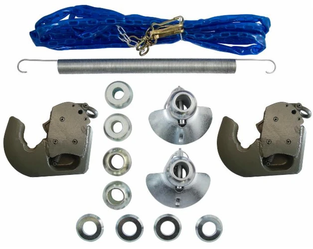

Not the cheapest by any means but in my opinion and having used most every style of 3 point arms and a few quick hitches,
I much prefer the Euro hook type arms.
Such as these;
https://www.agristoreusa.com/products/cat-2-1-lower-link-quick-release-hook-kit
And they are also available from a TBN member, mtnviewranch.

   / Quick hitch for 3 point – options
#9
Such as these;
LouNY, I saw these as well - watched a video. Looked great but required welding and some precise cutting and alignments - skills I don't have. Otherwise, a great choice.
