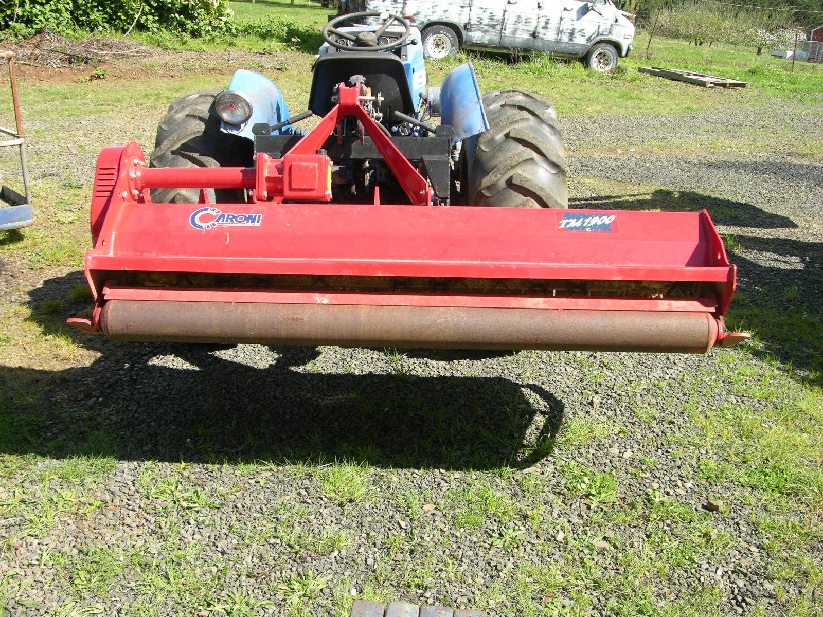

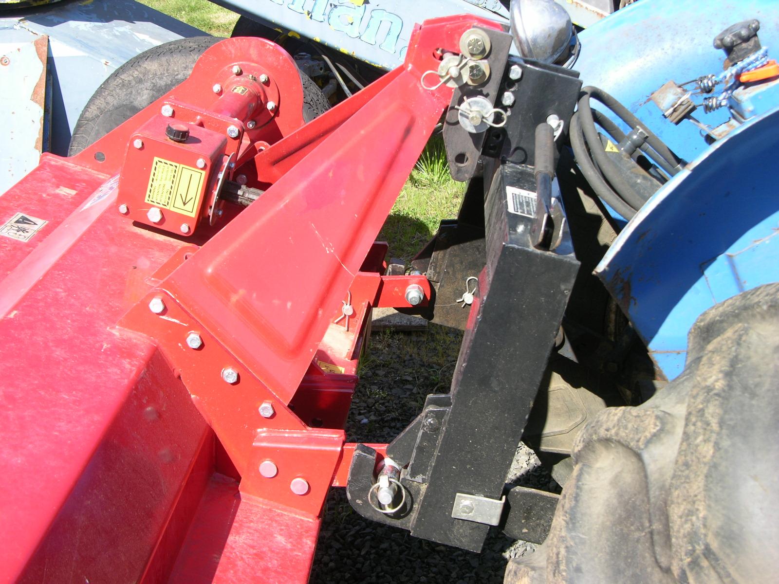

Just got my new L6060 with Landpride quick hitch. Worked great with landpride tiller but the 3pt top connection on flail sits too high. Any off the shelf remedies?
   / Quick Hitch and Caroni TM1900 Not Compatible? #2

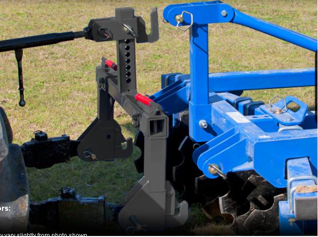

This is one option -
quick hitch toplink adapter - Google Search

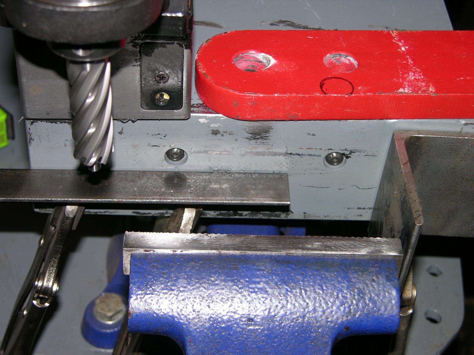

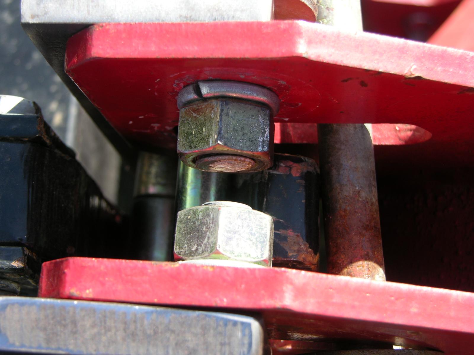

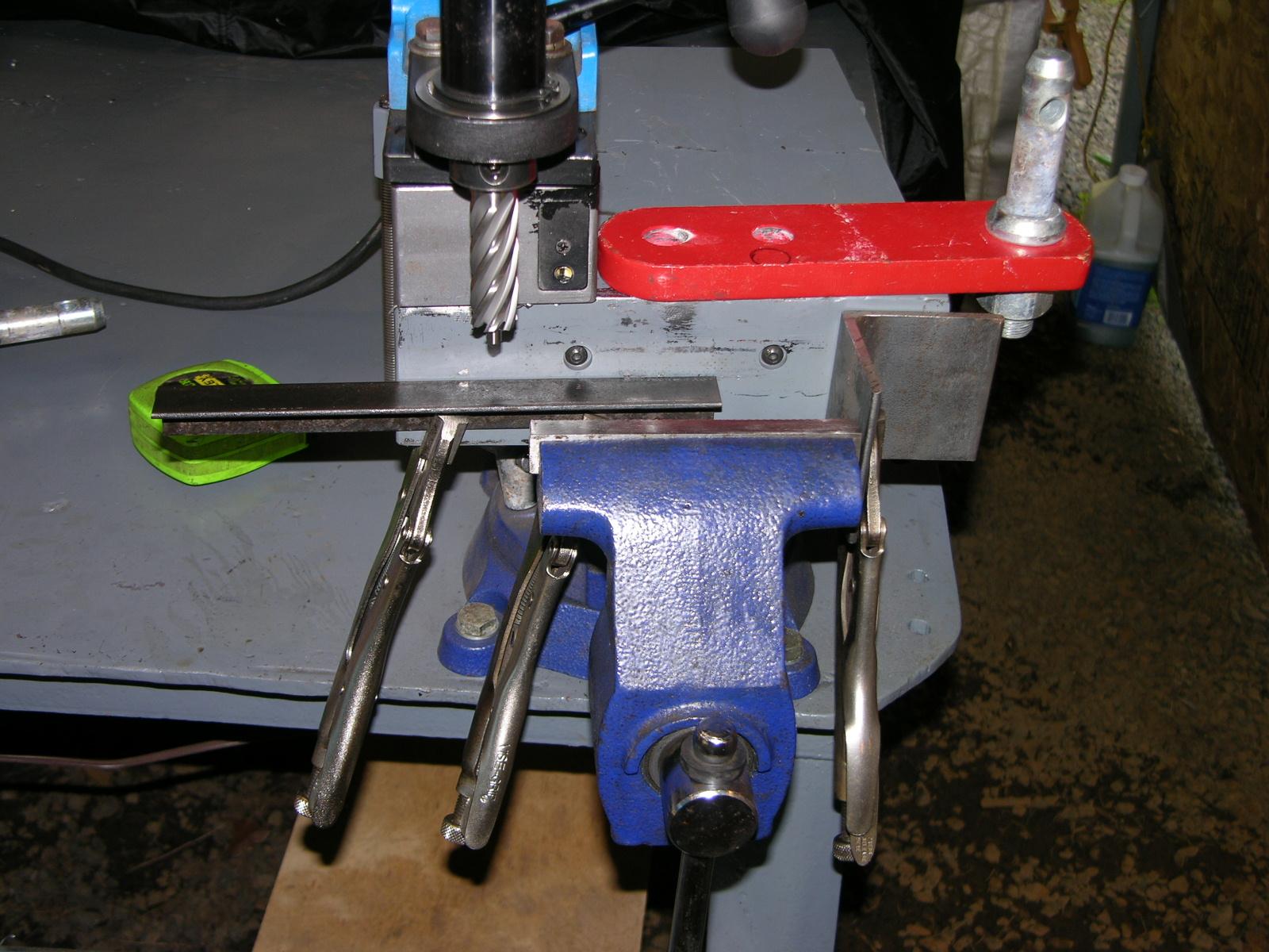

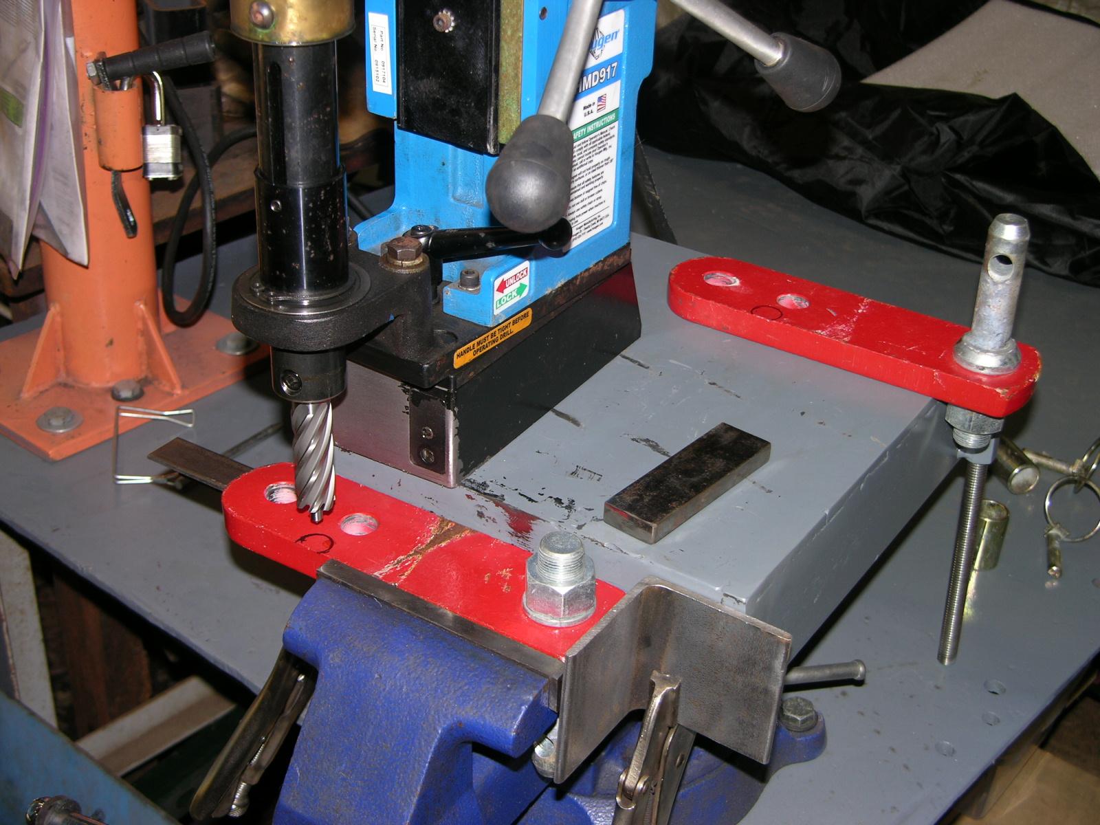

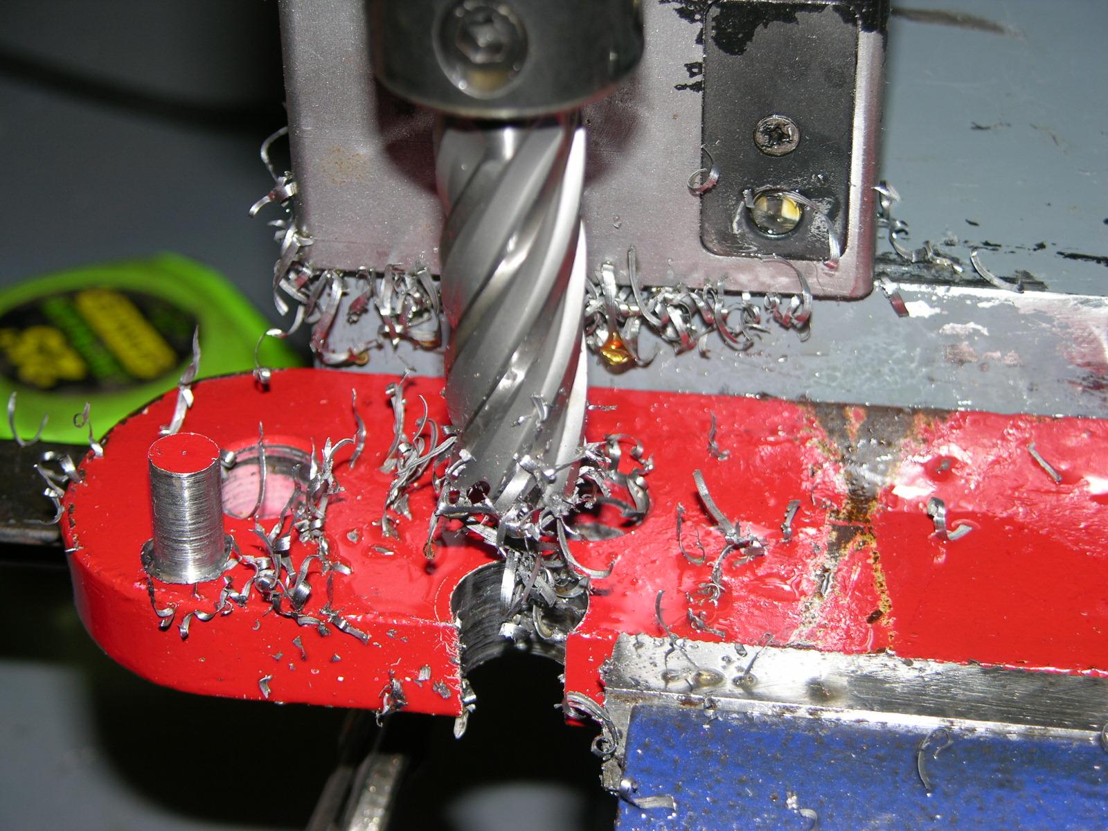

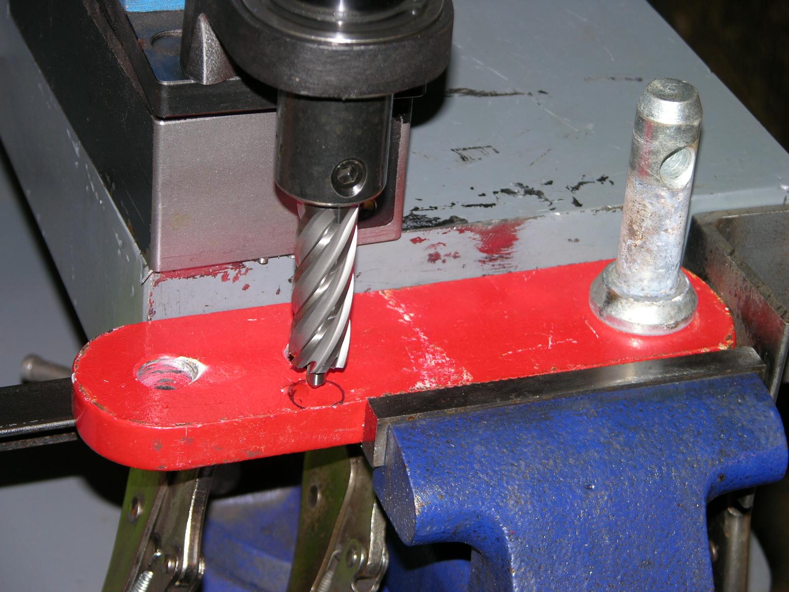

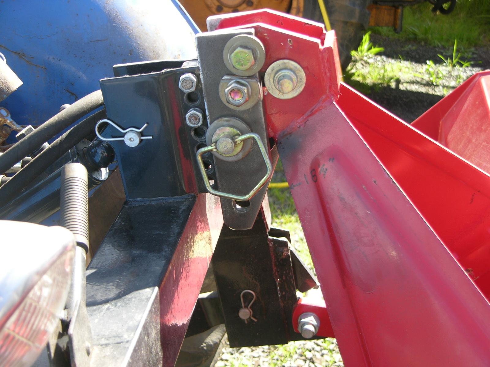

I did mine different, because I made the lower hitch solid (easier to pick up) - also, I leave the skids in the highest position and use my hydraulic toplink to set mowing height. With the rear roller resting on the ground, I extend the toplink til the blades hang 2-3" above grade. This won't work with everything on the hitch floating loose - pics below... Steve
BTW, drilling a "partial hole" like that isn't too easy without either a drill press/annular adapter/annular cutter, or the cutter in a mag drill, or a large center cut end mill...

In a word - no way. IME, width between lower pins is consistent enough not to be a problem, but NOBODY seems to agree on the height above the lower pins that the top hook should be, even though there are so-called "standards"
https://www.tractorbynet.com/forums/owning-operating/388498-there-standard-quick-hitch-height.html

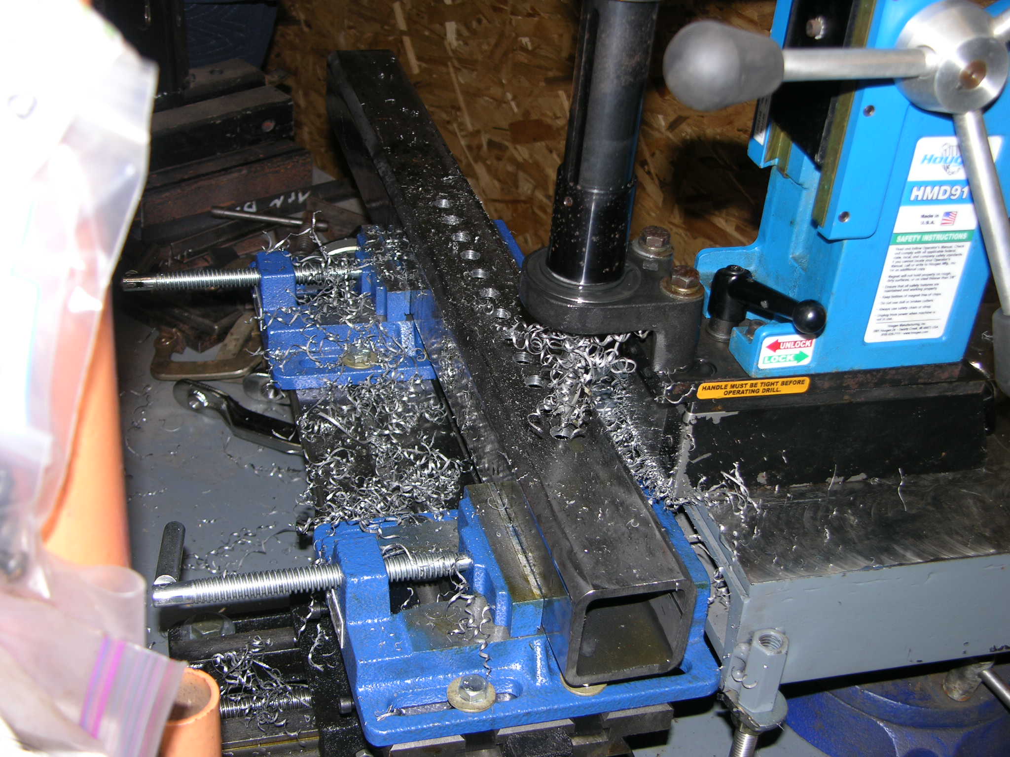

I have the HF quick hitches on both my 40 horse older tractors, and have modded a couple implements to match a 6' Priefert tiller's dimensions; still a couple more to go, but that hasn't reached the top of the "Project Pile" yet :rolleyes:
Priefert has discontinued about everything but horse fence stuff, but used to offer a spendier QH
PriefertMod2HFQH.JPG - eventually I intend to mod at least one of my QH's toplink that way, seems like a good idea some days :laughing:

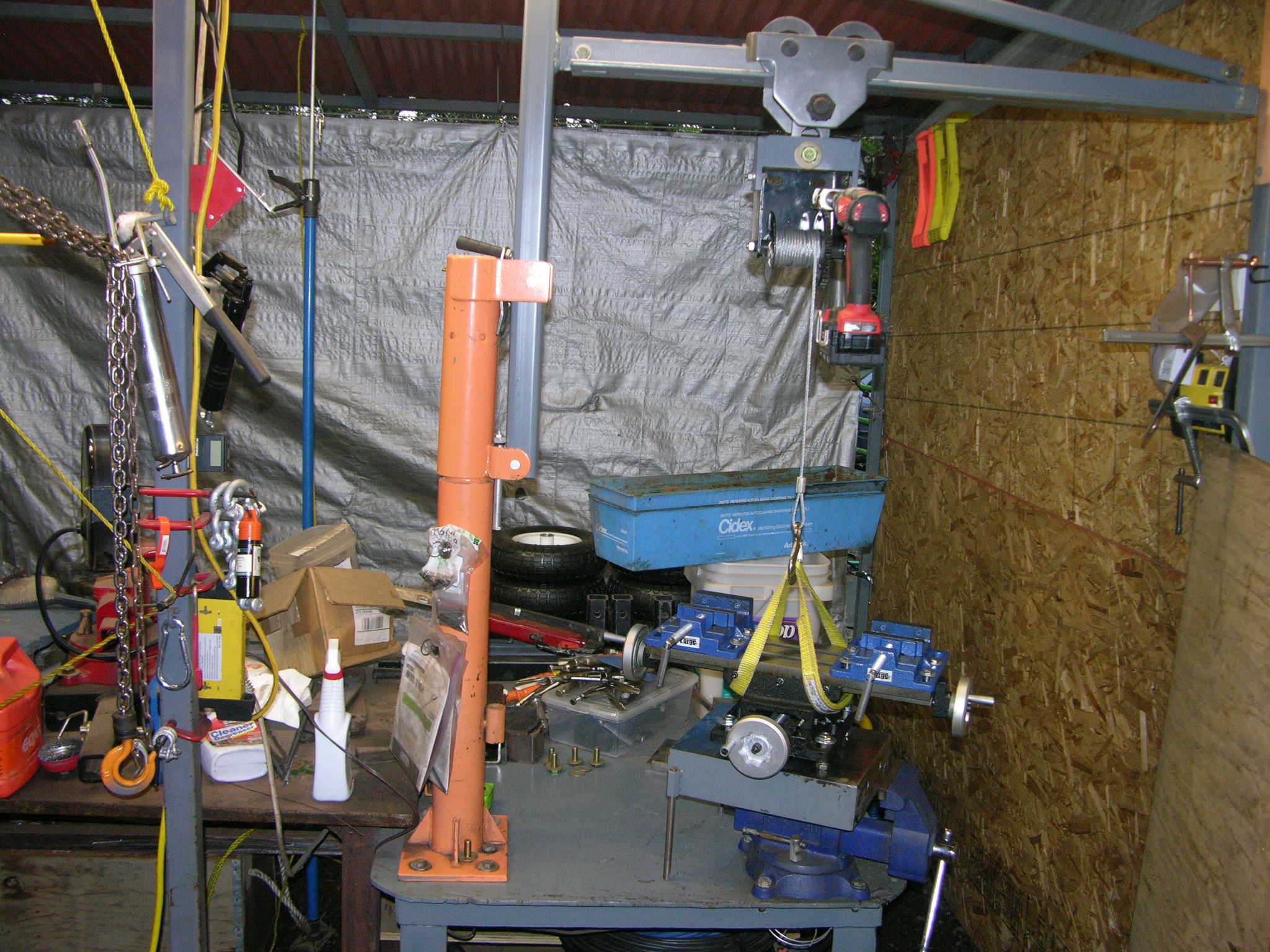

At least drilling all those holes will be fun, due to my "MDVT" project (MagDrillViseTable) XY-Rig-1.jpg XY-Use-5.jpg
