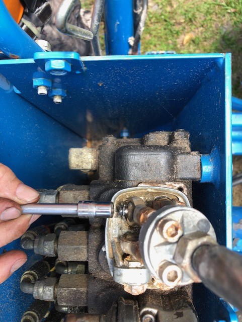

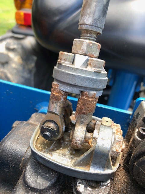

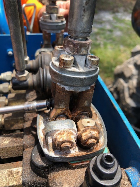

While digging out our dry pond during our month long drought, one control action stopped swinging the lower part of the back hoe.
My fix is only to get the equipment back into digging before the rain.
Will say that I was a bit disappointed in seeing the condition of the inside valve area.
The black rubber boots kept very little out as the level of corrosion was extreme.
Our tractor is kept inside & never left O/S in rain. Doesn't really get cold here in NE FL so just rain.

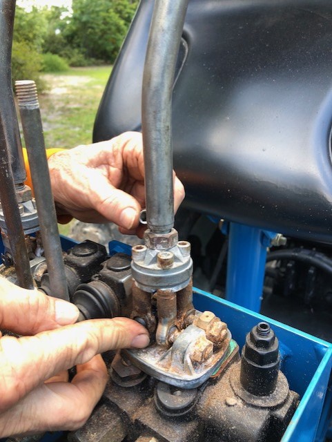

Most of the pix are self explanatory, but wife highly suggested I still try to talk some through what we did.
She is a retired school teacher..........

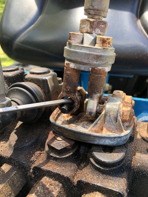

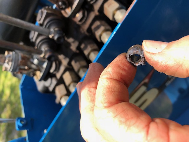

thumbnail_IMG_3128.jpg This is how the support ball should appear.
thumbnail_IMG_3135.jpg Note no ball but it was located on tray below.
thumbnail_IMG_3136.jpg Support ball out of place. Note clean & lube before fitting back on horizontal pin.
thumbnail_IMG_3138.jpg Easy to clean out clevis hole & ball but be sure to grease up.

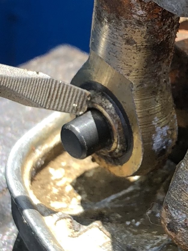

IMG_5204.JPG Using something we call a sheet nut to hold the support ball in place. Located on bloody finger.
IMG_5204 copy.jpg The pin is nearly 15/64 in diameter. Sheet nut had to be reamed out to 7/32. Just 1/64 less than pin.

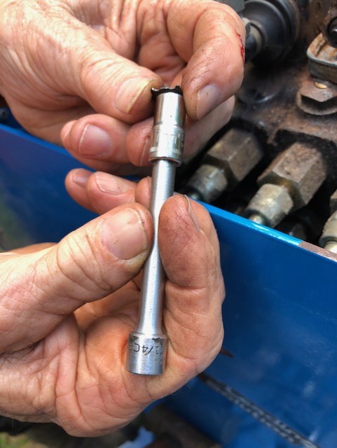

thumbnail_IMG_3144.jpg Used 7mm 1/4 drive w/ 2'' extension.
thumbnail_IMG_3160.jpg After fingers out of the way, keep tension on the nut by way of socket & extension.
thumbnail_IMG_3182.jpg At first this is as far as we tapped into place the sheet nut.
thumbnail_IMG_3180.jpg We checked the extreme angle of articulation before finalizing sheet nut.
We did both the right & left side of the support balls but will later go back inside & clean the entire area & replace the support balls w/ new SBs.

This has been an issue for I dare say almost all LB1100 hoe's or at least machines that use this valve set up. My hoe is a year and a half old and someone else had a similar issue so I decided to remove the boots and have a look. While mine didn't look quite as bad as yours there was water, rust and corrosion going on. I cleaned everything up as you're doing, lubed everything well and most importantly dried everything out. I then reinstalled the first boot and sealed the bottom as it was with a zip tie but also sealed the boot to the shaft with a zip tie. When I put the outer boot in place I sealed the top of the boot to the lever with another zip tie. When you disassembled this I'm sure you noted NO ZIP TIES at the top of the boots and thus the problem.
So like you I wondered how the water got in there in the first place as I store my machine inside out of the weather. Well when these machines roll off the assembly line you can see pictures of them online of being stored outside in the weather. Also I have never seen a dealer that stored all their tractors for sale inside. Before I actually purchased my tractor I have pictures of it at the dealer out in the rain and all wet, so I certainly know where the water came from. It would save a lot of grief if the factory just used 4 more zip ties and double seal these valves as I have done and I'm sure you're going to do when you're finished.
