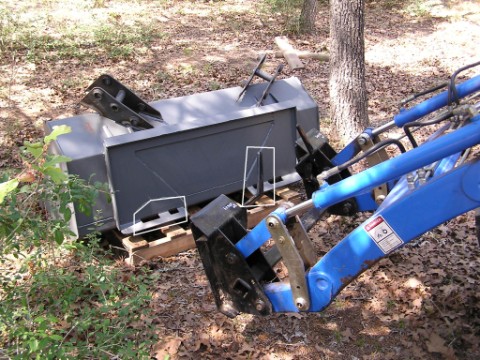

I want to convert my fixed bucket 17la FEL to the quick connect type. Can it been done with factory parts or do I need to make the parts myself?
Does anyone have good pictures of the quick disconnect and how it works?

I just did it to my 16LA .... bought the QA from NH dealer ... then bought a QA plate online, cut off the pin on brackets on the bucket and welded the plate on. Here's a shot of the whole thing after - the pin on brackets are sitting on top of the bucket.

cost was about $600 total .... the plate came from qualityweldingservice.com. The part you'll need for the 17LA I'm betting will be a tad different than for the 16LA so you'll have to ask your NH dealer about that. The QA for the tractor was the most costly - about $450 .... the plate was $100 ....It's a very easy thing to do -- just jump in and do it. First thing is to get the QA from NH. Once you have it - just looking at it will tell you how it works ----quite well actually /forums/images/graemlins/grin.gif .... In my pic - I've put white lines around the handles that drive the lower pin into the bottom holes on the plate (white line again) You just put the wedge shaped top of the QA into the top slot on the bucket plate - lift - then drive the pins down to secure it.
