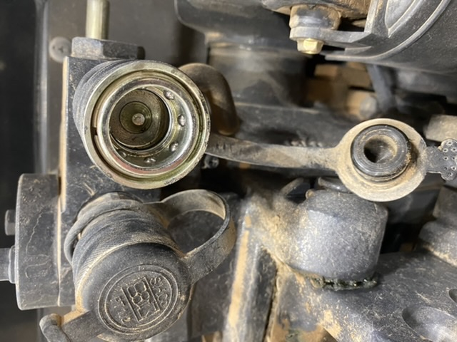

My new to me tractor has these couplers for the rear remotes.

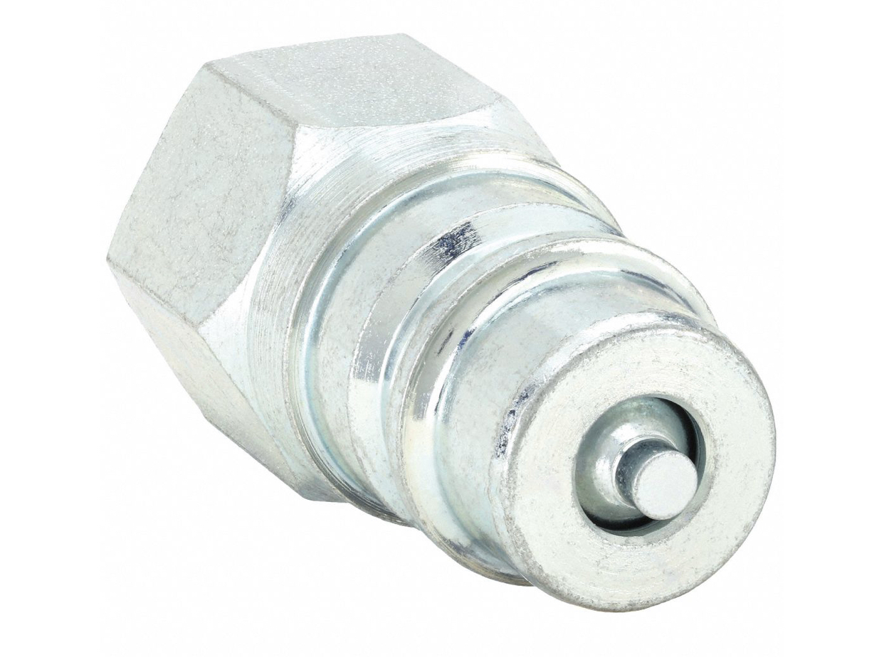

I believe these are the correct make couplers to use, the ones with the pointy poppet.
However I have a pile of these couplers in my shop. I tested one, tractor off no hose attached, and they seem to fit fine. Are these with the ball ok to use with my tractor or should I get the pointy ones?

either design will work, the pointed ones will at times couple up easier.
That said that same profile is made in several diameters

You can technically interchange poppet and ball style tips, but most would advise against it.

My tractor came with poppet remotes, and the dealer sold me a TnT kit that has ball-style connectors on its hoses. They work fine, as they're both "Ag" series. Note that there's a poppet style in the 6600 series which have a different shape and will not interconnect, but they would be quite obvious as they're slightly different diameter and wouldn't lock on.

^^^ Yes. I have both types and they both work fine. The pointy type are designed to be able to hook up under residual pressure if you tend to face that issue.
