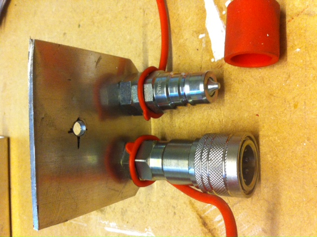

I'm adding rear hydros to my MF35 and have bought 2 pairs of quick connector for flow and return coupling.
Is it OK to use a bulkhead fitted male on the tractor for the return path? In that way it would ensure the hoses are connected the right way round.

Another option to consider.
Some people will reverse the direction on one set of couplers to prevent mixups when connecting and disconnecting attachments.
   / Quick Connectors
Hi Ken and thanks for the reply.
I think what you are suggesting is what I am asking - see below.
Is that what you mean?
