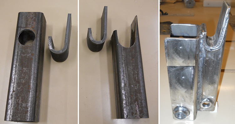

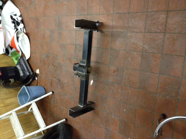

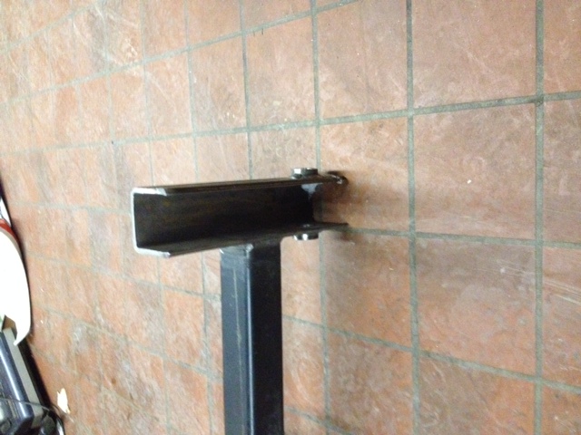

Okay just got some of it back from Welder only took almost 2 months
Save alot of time by using a trailer hitch off a 1997 jeep cherokee remove ends and had 2 3" tubing cut 1' cut the face off the tubing and welded to hitch, then added bearing to the 3" tubing , I think that's what there called. Its now ready to mount on tractor the other part that go's on the part i just made is being welded up today I hope
Sam
Here's a picture of what the other part being built will look like when done2.jpg
I Need to thank 600rider for his posting of his quick attach as that's were the build came from as well as the last photo i just uploaded. This setup should work on the t5 and up with some messurement mods.

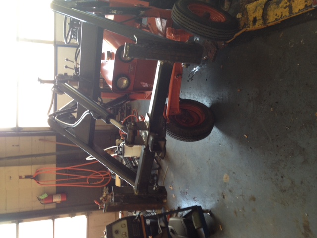

   / Quick Connect ?
#9
Okay Making progress now bracket is pretty much done except for some hooks and paint, Bucket is next as well as a carrier for a post hole digger. I cant afford one of those fancy hydralic motors so Im going to get a gas powered post hole digger and make a hanger for it to attach to hitch bracket
