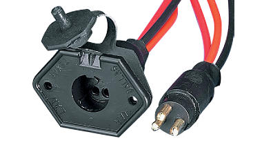

These trolling motor plugs work great. They are cheap and can handle a lot of current.
Can these handle salt water? Thats what I need for my salt spreader hookup.
   / quick connect plugs #10
I think they would work OK. They fit together quite tightly. Add a little di-electric grease and you should be good to go. Cabelas has them or try Ebay.
