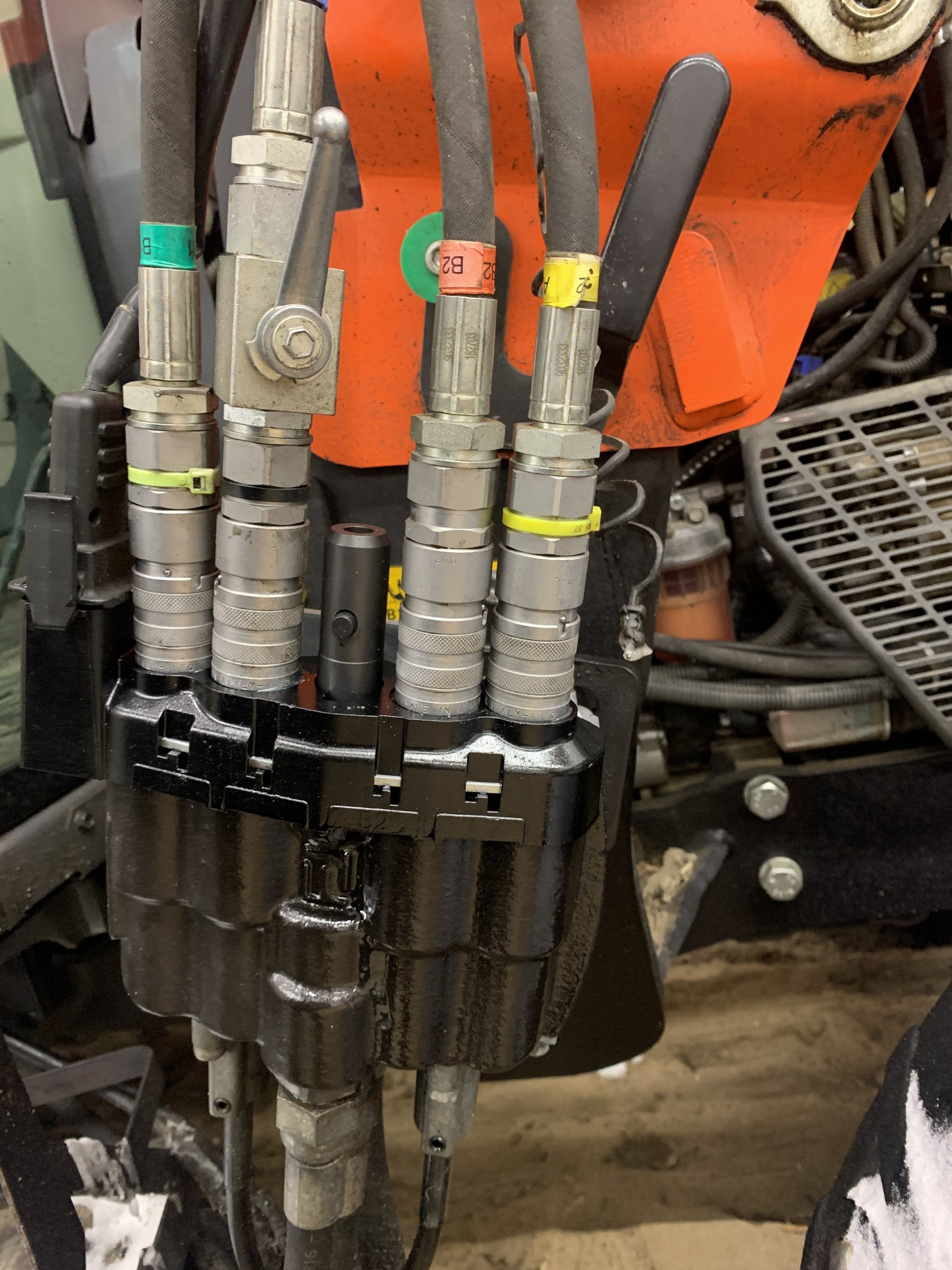

They don’t connect as easily as you think.
when there’s some pressure built up in the system (from sun/sitting and temp change) the pressure can’t be ‘relieved’ nearly as easy by whacking the tip!!
These still leak. I can’t tell from where but haven’t put much effort into it. it’s not from being loose on the hose/valve I do know that…..
   / Quick connect coupler recommendation
What brand are those?
Also, looks pretty clean
You should see what the rear of my L4740 looks like
I wonder who makes the Cat couplers...

Anyone finding this in the future... Kubota front 3rd function on my Kubota M59 the parts diagram shows the CAP on FEL hydraulic as 1\2-14 NPTF (where factory parker QC are hooked up or a CAP) so you can use 1\2 NPT Skid Loader \ Flat Face coupler WITH Teflon tape (rated for hydraulic fluid\oil). The backhoe hose for thumb goes 1\2 to 3\8 so you need to change this to use 1\2 connections if that's your goal which requires a NPT to NPT nipple, and then the flat face connector if you use the bracket to hold the hose in place, if you want to eliminate that it looks like you could go from the tractor-side hose 1\2 to (existing) nipple to 1\2 NPT quick connect.
