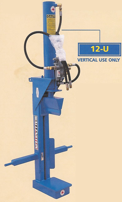

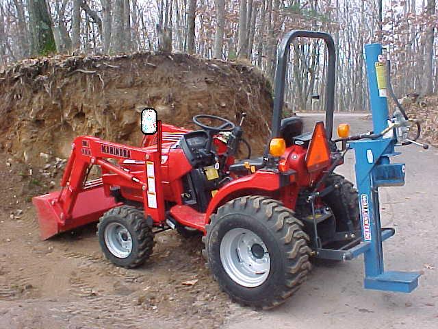

I have a 3pt Wallenstein log splitter that I hook to my loader valve and it works great. I still have full use of my loader when it is attached. The hoses are kind of a pain, but it is not attached very often or for long times. I have read here that some lose one or more functions when attached.

This looks like what I am thinking about.
I would like to connect the spliiter hoses to the quick-disconnects that open/close the 4n1. Will this work?
