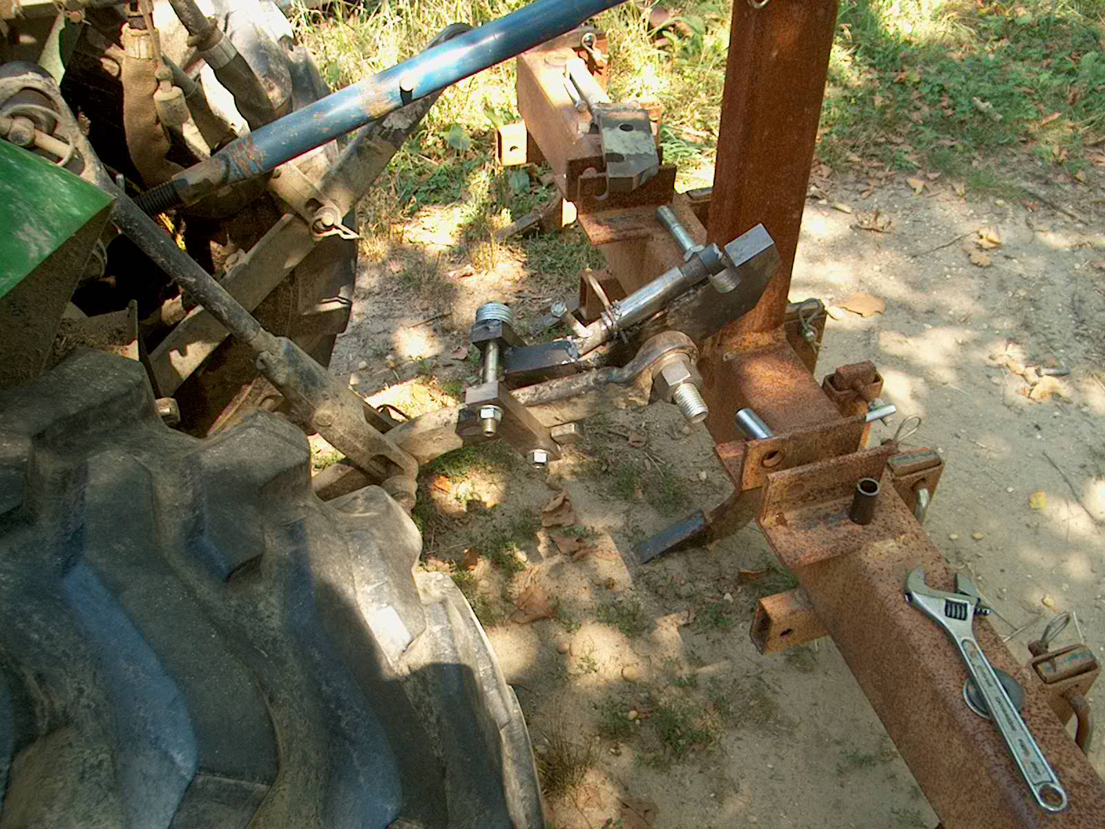

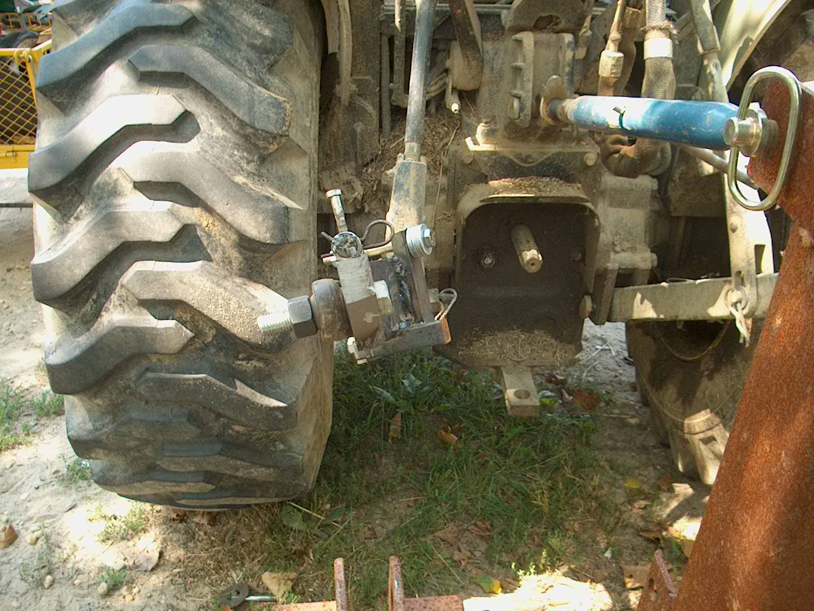

they fit either inside or outside the lift arms to vary the spacing

Homebrew easychange?
Is the top capture rod in a sleeve?
   / Quick attachment connectors
if i understand you, thats what the clip is through
i hooked up the mower yesterday to do some mowing.
what a difference, make sure they are spread properly backup somewhat square, lift and backup a smidge to alligne and lift to seat, no more struggle.
one chang ill make when time permits is to chamfer the outer portion of the impliment pin recepticals to allow more of a rocking motion to simulate the balls.
but for now it does what i need
