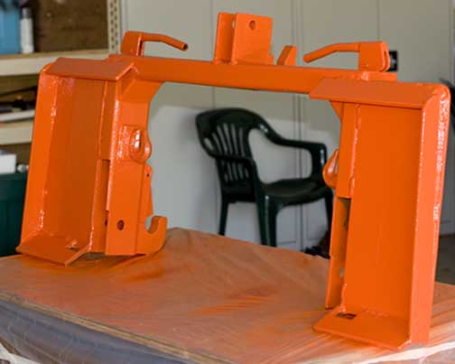

I enjoyed reading down thru these posts to find out who was on the right track!! I was with Radman1, but you never know!!! But Hey,,, look at the bright side,,, you also got some great quich hitch advice!!! Hahahahahaha!!!
Here, just for giggles, I'll attach a picture that applies to both ends!!! ;)

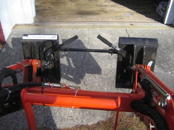

Often you will see the term "universal quick attachment" which is essentially the newer Bobcat style. As Radman noted, this is the non proprietary type that is most useful if you want to mix and match implements/brands etc.
ATI and a number of other companies sell adapters for pin type tractor loaders so you can use universal quick attach implements.
