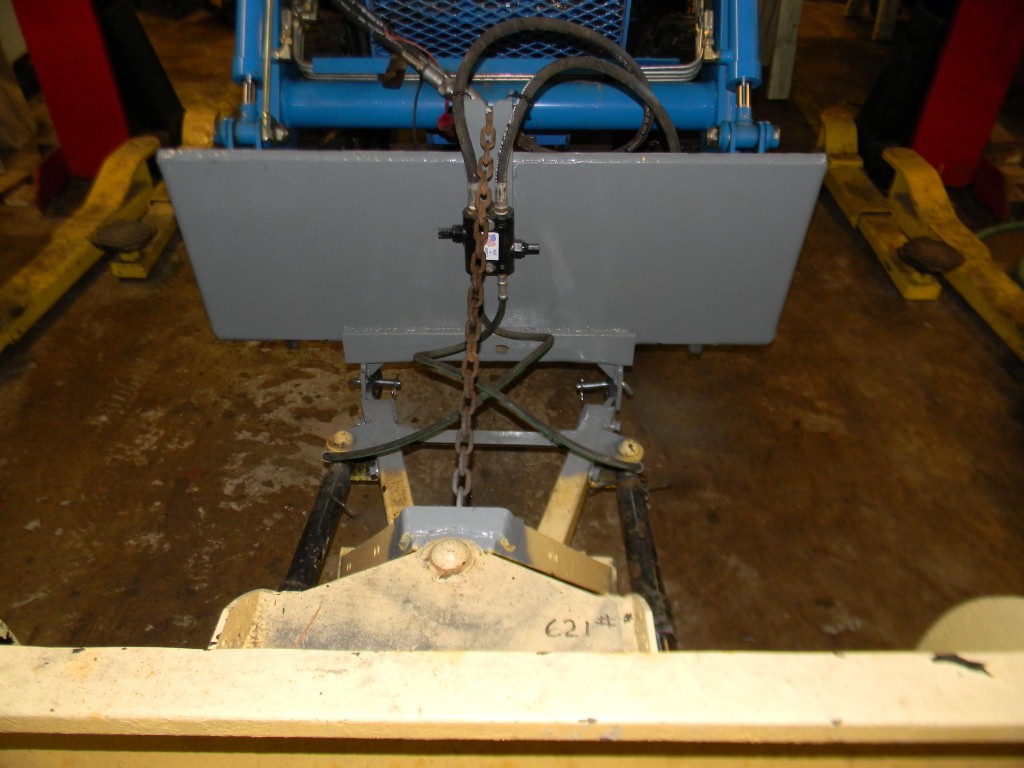

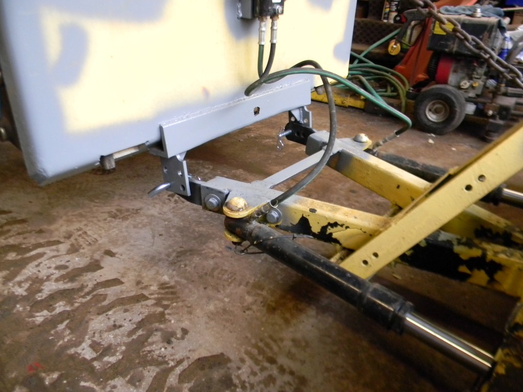

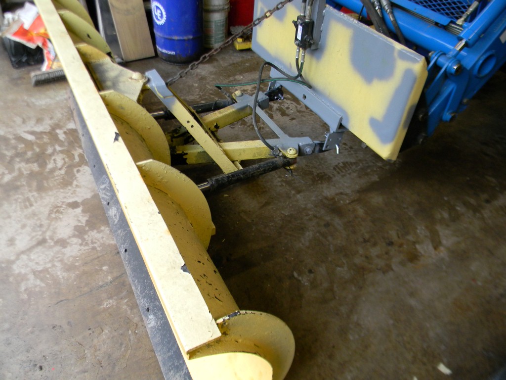

Thanks for the replies, it is always better to have some information! Now off to the order a plate. I see that some are "partial plates" and some are full, any ideas on the benefits of either?
Full or partial plate depends on what project you need it for. I bought a full plate to which I attached a 7 1/2' truck plow.
If you are converting a pin on bucket to a QA bucket a partial plate will work.
