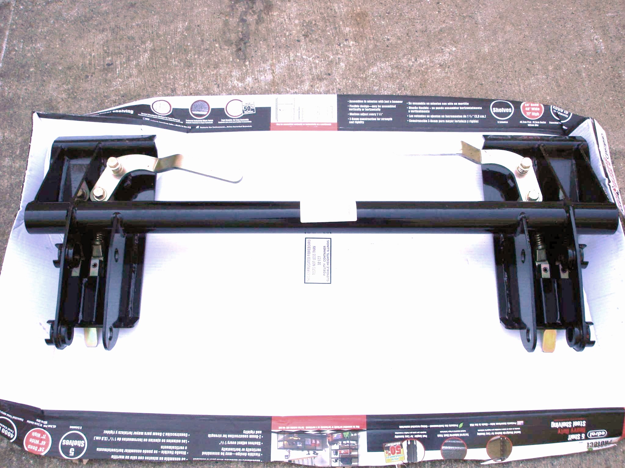

Kioti makes a QA for their new KL130 loader arms that will fit the older pin arms. I just changed mine over. Depending where, it's @$300 plus shipping. The QA is well built but not overdone considering that we can only lift 1200lbs. It fits the skidsteer style attachments. Some of the aftermarket QAs are twice the price and built like they should be for at least a DK45 or more. A Kioti QA bucket is @$450 plus shipping or you could check out everythingattachments.com. They have a compact tractor bucket but it seems a little heavy for our fel and I don't want to lose lift just because of a heavy bucket. They say it's for up to 50hp tractor. That's a big difference. I think I remember seeing boom poles there too. Or you could go white and look at the QA bucket for a Bobcat CT230. No clue on the price.

Here is a picture of the Kioti brand QA adapter if you wanted to know what it looked like. I saved this from another member but mine is the same.
