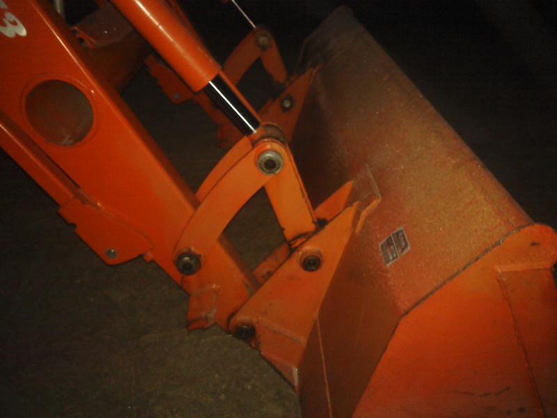

Hi I recently purchased a 2005 L4330 with the LA853 loader. Is there a way to get a quick attach system for the bucket? I've attached a pic. Guessing I would need a new bucket too.
Thanks

well i know that Quick Attach makes different retrofit quickattach systems for lots of different makes of tractors.
www.quickattach.com
heres the link for the LA853 loader
Untitled Document
   / Quick attach for LA853 loader #3
Keep an eye on Ebay, I just bought a Kubota OEM Quick attach for my L4200 for $200 and it looks brand new.
Mike
   / Quick attach for LA853 loader #4
Yes you can and will need a different bucket. We have a 5030 with SSQA.
You might need a new bucket unless you use the brackets from your existing bucket to put on a Q/A unit. You would have the bucket stops built in then. Give this guy a call, I really like some of the features on his Q/A. If you used the brackets from your bucket you could then just weld on a blank Q/A plate to your existing bucket and be done! I have done this with several buckets and it is not that difficult.
