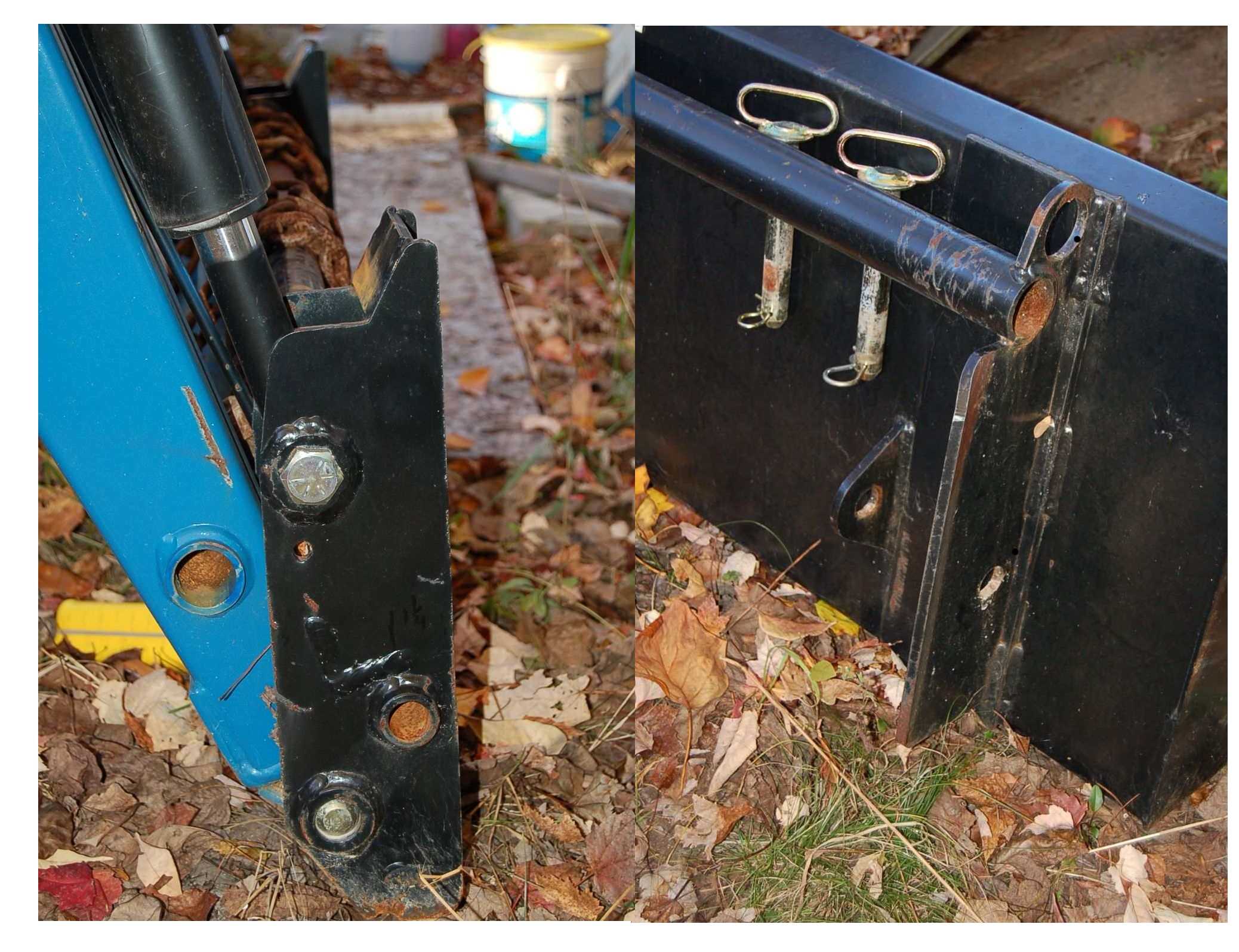

My loader is a koyker 210 . I'll take some photos in the next couple of days to show how mine attaches. I'm not familiar with the skid steer quick attach type. I looked at your website and was wondering the cost of the FLM42. I pretty sure I could find someone to make the bracket to attach it to my FEL.

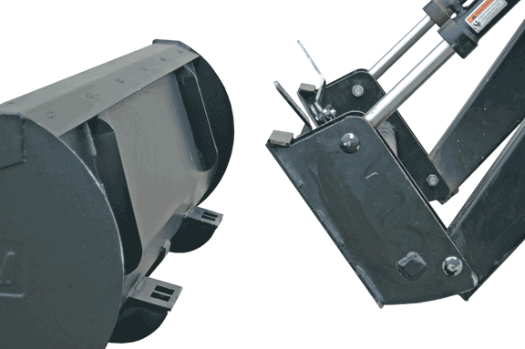

This forklift's suggested retail is around $775. If the lift capacity of your loader is over the 3000# mark, you'll want to use the larger model, FL-42which is closer to $1000 retail. I've attached a photo of a skid-steer style quick attach, is this what your's looks like?
   / Quick attach for Koyker FEL.
Here is a couple of photos side by side. Left is Tractor side and right is the bucket.
   / Quick attach for Koyker FEL. #7
Great pics. It seems to be a cross between a skid steer top, and pin style bottom. I'm sorry to say it doesn't match up to any of our current adapters. The receiver bracket on the back of the bucket does look simple enough to recreate. Have you checked direct with Koyker, the Manufacturer, to see if they offer these plates as replacement parts?
