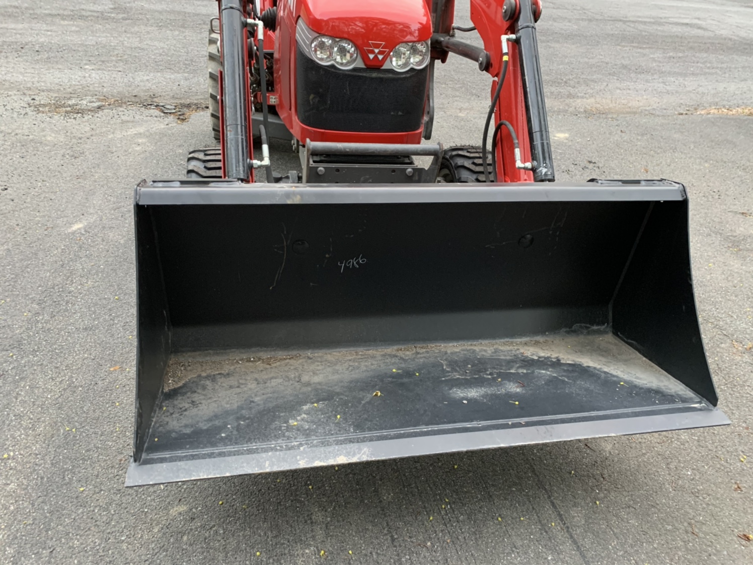

I got quoted $1100 plus tax for a quick attach (650) plus bucket (450) plus tax for my GC1720 DL95. I was thinking if I convert my existing bucket to a quick attach (maybe another $300 parts and labor), I can dedicate that bucket for the BXpanded Piranha tooth bar. Its a lot of money and I still need a box scraper and possibly other attachments. I would like some of your opinions before I make the purchase. I feel like having a quick attach makes the tractor more versatile in the long term.

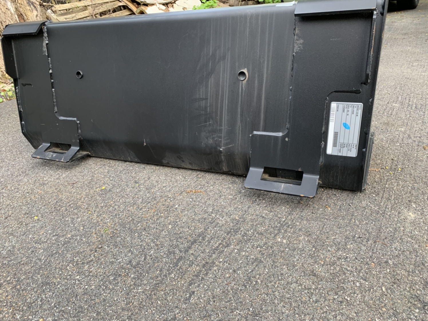

I think having the extra bucket will be nice as I won’t have to wait to covert the other before I can use the loader+bucket. Thank you guys for your opinions. I am worried the PTB would damage my asphalt and concrete and I don’t feel like taking it on and off all the time so a second bucket worth the tooth bar I can leave on will be nice. If I have the backhoe off, could I use those hydraulics for a grapple? Just need some sort of controller for it?

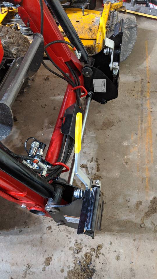

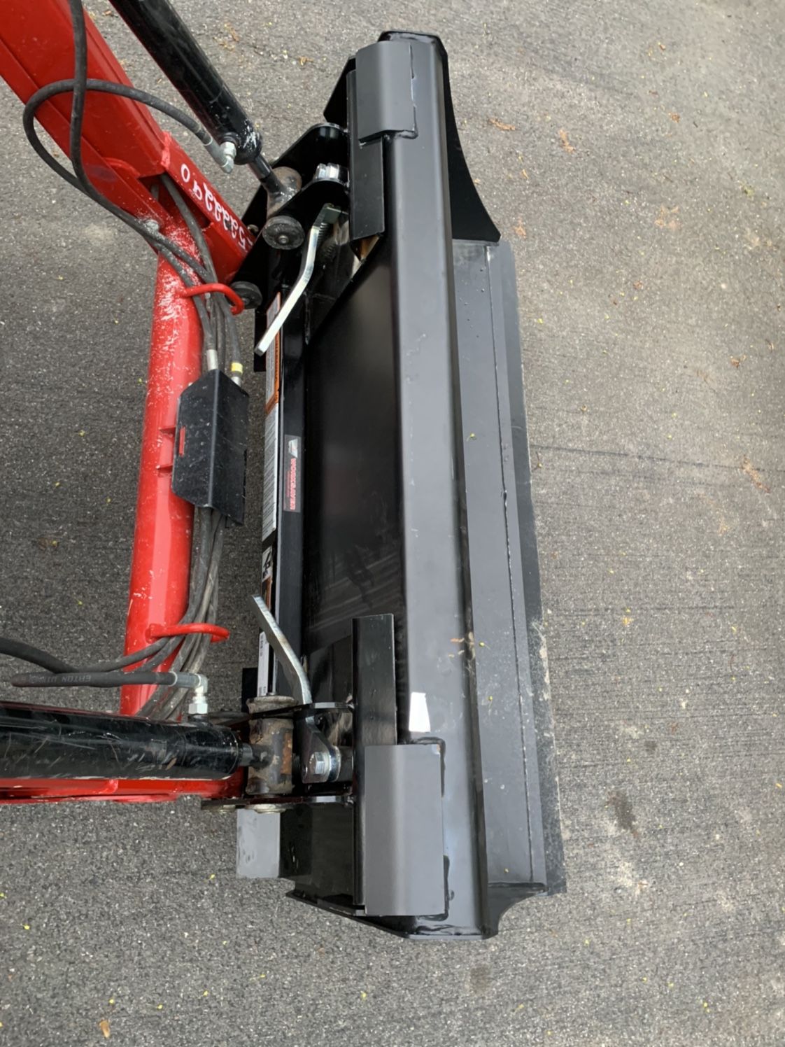

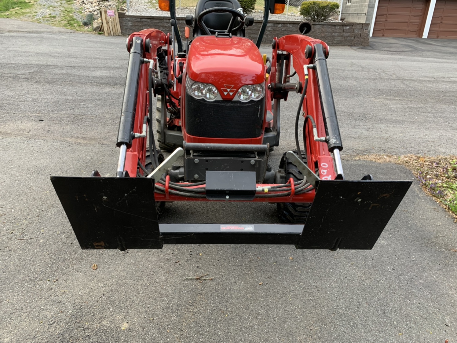

Well, it’s installed. Excited about all the potential now for attachments.
Looking to buy this and welding it on the old bucket after I remove the brackets behind the bucket for the pins. YINTATECH 5/16" Skid Steer Mount Plate Quick Attachment Loader Plate Compatible for Kubota Bobcat Tractor https://www.amazon.com/dp/B07S73ZQD2/ref=cm_sw_r_cp_api_i_V-0SEbH2V9ZYN

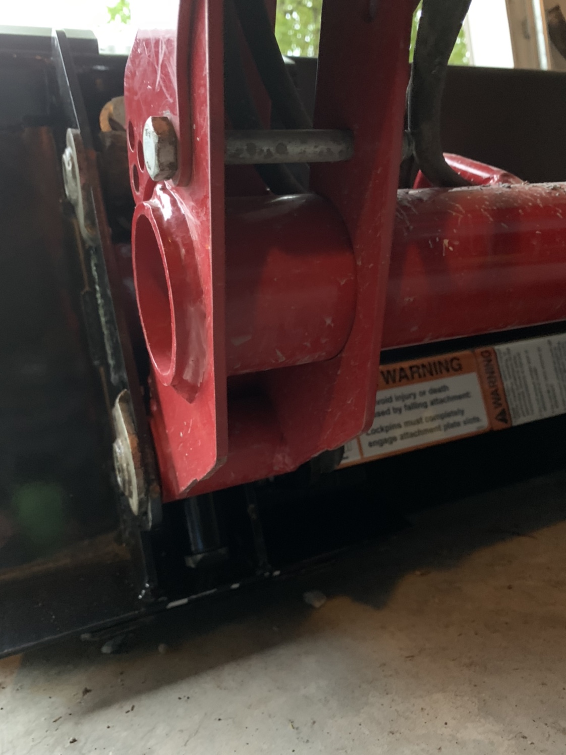

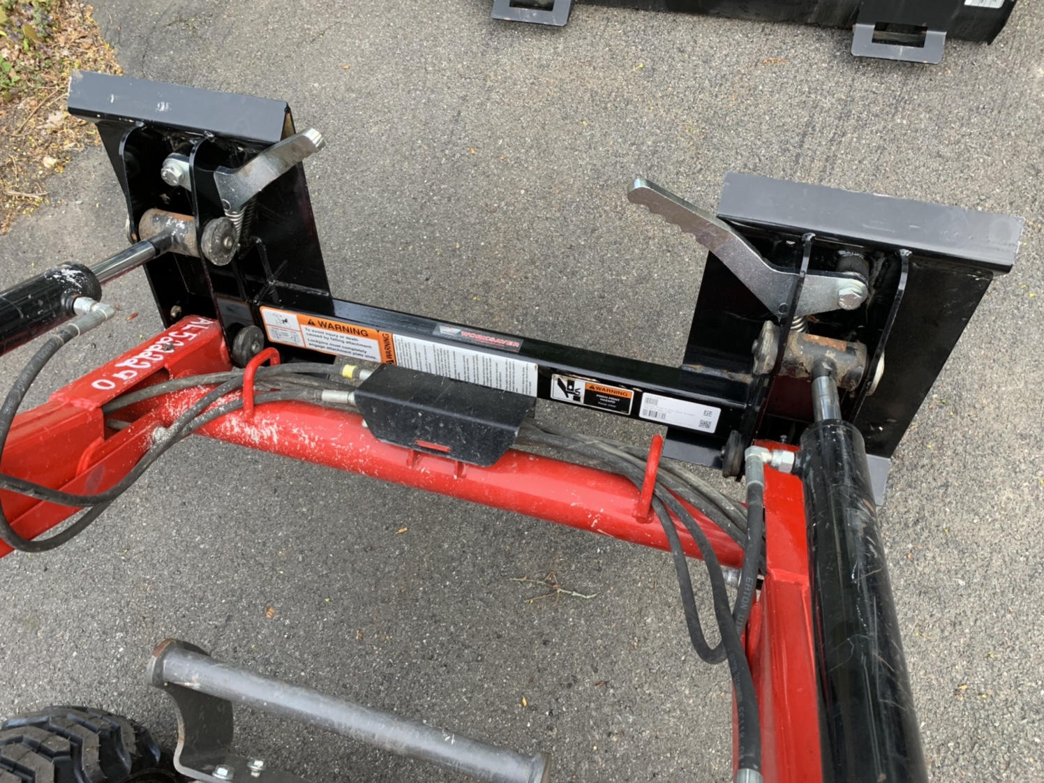

The dealer thinks I should box in the front portion of the dl95 to strengthen it. He said he has seen it fail before. See the portion around the lateral support tube and both. Behind and below. Fully boxed in. IMG_3232.JPG
   / Quick attach for GC1720 #9
AlbanySamurai; The dealer thinks I should box in the front portion of the dl95 to strengthen it. He said he has seen it fail before. See the portion around the lateral support tube and both. Behind and below. Fully boxed in. [ATTACH said:
654285[/ATTACH]
Aren't you just moving the potential failure point to something more expensive to repair?
   / Quick attach for GC1720 #10

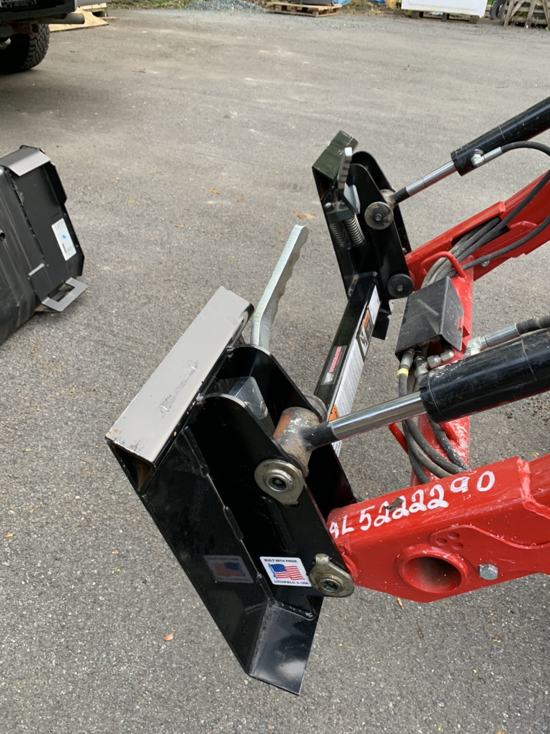

Looks like they changed the design of the SSQA toolkit. Mine looks quit different than that. Looks like they shortened the distance between the plate attach point and the pins. Also went with a welded steel cross member vs lateral roundstock through the bottom pin mounting holes.IMG_20200325_193803.jpg
