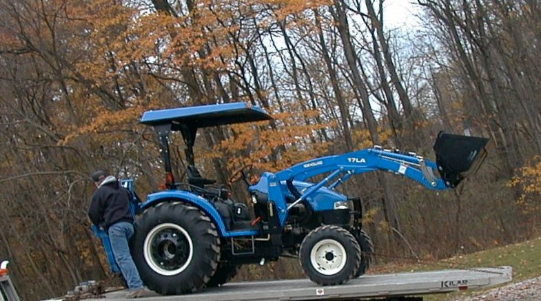

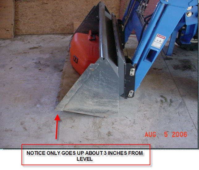

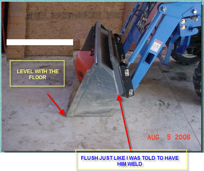

Now the bad news. I have a 7308 loader and I wanted to get a quick attach system to eventually get a snow plow for the loader. I bought the unit from my dealer. I bought the plate and the actually QA that goes on the loader arms. I had a guy weld the plate on per the dealers instructions. The problem is, my bucket now has 4-5 inches less curl then it did. We ground off the old attach area on the bucket per the dealer. We then welded it on exactly where it should be.
I think they gave me a bucket originally that was made for a skidsteer and it doesn't work right when using the loader arm QA system.
I have attached some photos that I took. I have asked the dealer to fix it. One thing I did notice on his lot were the buckets with the QA built in. They seem to be about a 75 degree angle and the bucket they gave me has about 90 degree angle when sitting flat. Again, I think they gave me the wrong bucket.
Can anyone tell by the photos?

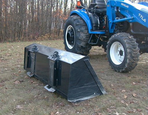

You're right, that isn't going to work very well like that.
Here's a couple of comparison shots with the QA set-up.

Bob, I agree that your bucket is never going to be able to curl more without having a sharper angle on the rear. I think your bucket is made for the loaders with the extra braket we have between the hydraulic ram and the attach point. With your setup, you can only achieve more rollback by having a bucket at about 75º as you stated. I'd try to get the dealer to help with that too, especially if he picked out that bucket as the one you should have. He may be able to put a wedge on the bottom of the plate and get your geometry where it should be.

My ATI QA system seems to have some angle built right in, so a standard skid steer bucket works just fine on my 7308. I agree your dealer should fix it.
