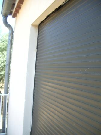

Here are Pics.

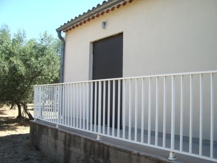

Photo1 = Next Bedroom over, a view of a patio door opening wiht the steel roll up shutter rolled down

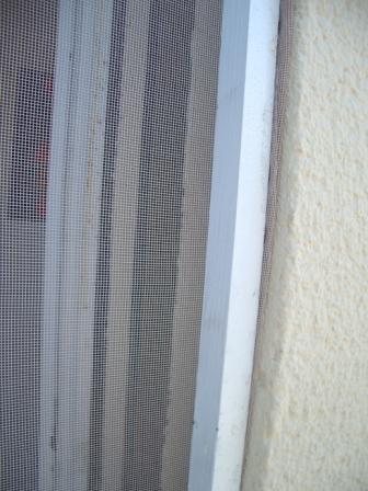

Photo 2 = A closer view of Photo 1

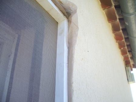

Photo 3 = White wood frame screen from interior. Screen material is stapled to the interior side.

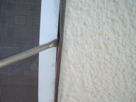

Photo 4 = White wood screen showng excess screening material tht was stapled on the interior (jsut cut one big square of screening matierial an extra 4" bigger all around, than the wood frame) and pulled through to the exterior when window screen was placed in opening.
Photo 5 = Use screwdriver to poke and give a twist to stuff the excess screening material between the wood screen frame and the home wall.

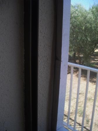

Photo 6 = Close up of excess screening material tucked in

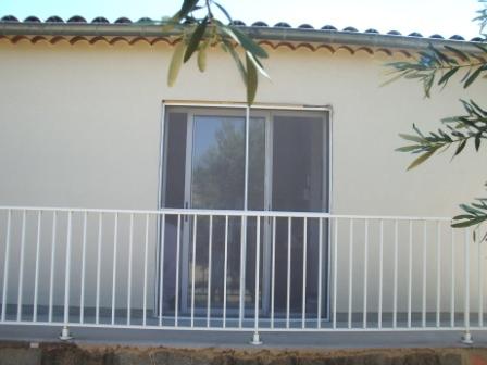

Photo 7 = Zoom Out view. Therre is a cross bar on the screen but it lined up with the horizonal top rail fo the fence so you dont' see it in the pic.
