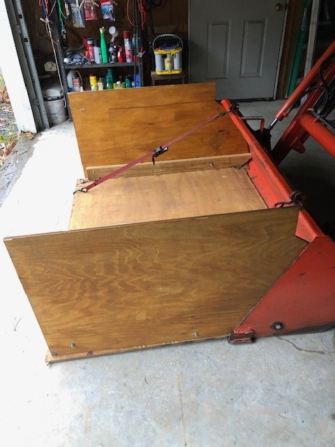

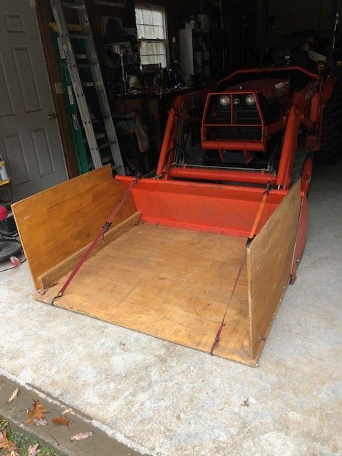

Used for light materials: grass, leaves and chips. Little over 1 yard capacity

I like this. Especially the simple attachment.

I wonder if you could weld a couple tabs inside the back , bottom of the bucket that would stop the plywood from wanting to flip up and forward.

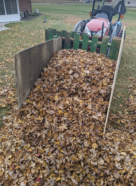

I built this contraption out of scrap pallets and plywood and lumber I had around the property and FILs barn. It was better than a tarp but what you built appears to as it would be better. Used pallet forks with it. I could build something like you did for my pallet forks.
2 by 4 on the bottom of each side preventing plywood from moving up and straps holding it in place. Never moved at any direction. I can screw plywood to 2x4s if I don't want to use straps.
