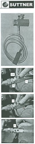

As a follow-up to my original post I took the good advice from MadReferee and purchased a Suttner upstream soap injector for our power washer.
You may remember that I just wasn't happy with the setup for dispensing soap while pressure washing. The way the pressure washer came to us whenever you wanted soap you needed to use a chemical tip in the end of the lance. At that point the pressure washer delivered soap but at reduced pressure. I guess the idea was to soap up the item, let it sit, pop in the high-pressure nozzle and rinse the soap and grime off which just didn't work for us.
The Suttner unit solved that problem and was easy to install. Screw it on the end of the water supply hose and connect the other end to the power washer.
With the plunger in the up position the pressure washer works like normal.
When you are ready for soap you drop the chemical line into your soap solution, align the notch up with the shoulder bolt and depress the plunger down and turn it clockwise to lock "on". You are then spraying soap solution at high pressure just like the car wash.
There is an adjustment that you can make to use more or less soap (see picture 5).
When you no longer need soap you turn the plunger to line up the notch with the shoulder bolt. Pull the plunger up to the "off" position.
The Suttner ST-64 soap injector seems to work well so far and the pressure washer is much more effective being able to dispense soap under full, high pressure. If this injector continues to work with little or no maintenance then it will be well worth the purchase price of 29 bucks.
If you have a pressure washer and want or need the ability to inject soap at high pressure then you might want to check out a Suttner injector for yourself.
