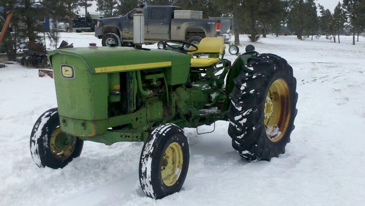

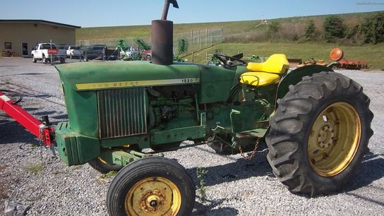

I'm trying to educate myself on prior to using my tractor this spring. The JD 1520 I bought doesn't have the front side screens on it. A lot of the ones I see on the net do. What are these screens for and do I need them? I am attaching two pictures. One is my tractor. The other is one I got off the net that has the screens in place.

I would have them, much easier to brush off the screens than try to clean the radiator. The screens should still be available from either Deere or Yesterdays Tractors.
FWIW, your tractor looks to be in decent shape, sure would look good with a few fix ups and a paint job.

As stated above. The fan pulls air thru the radiator, the screens keep debrie from reaching the radiator. You really need them if you mow in the fall when everything has gone to seed. The ones on my 2030 look like they have fur on them when I mow in the fall.
Ebay is another place to look for a pair, be sure they are for your 1520, I Think three cylinder tractors use narrower sceens than four cylinder tractors, but not sure.

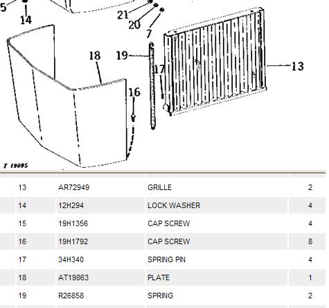

Each screen is held in place by a single spring. Don't forget them, may have to order from a dealer.
