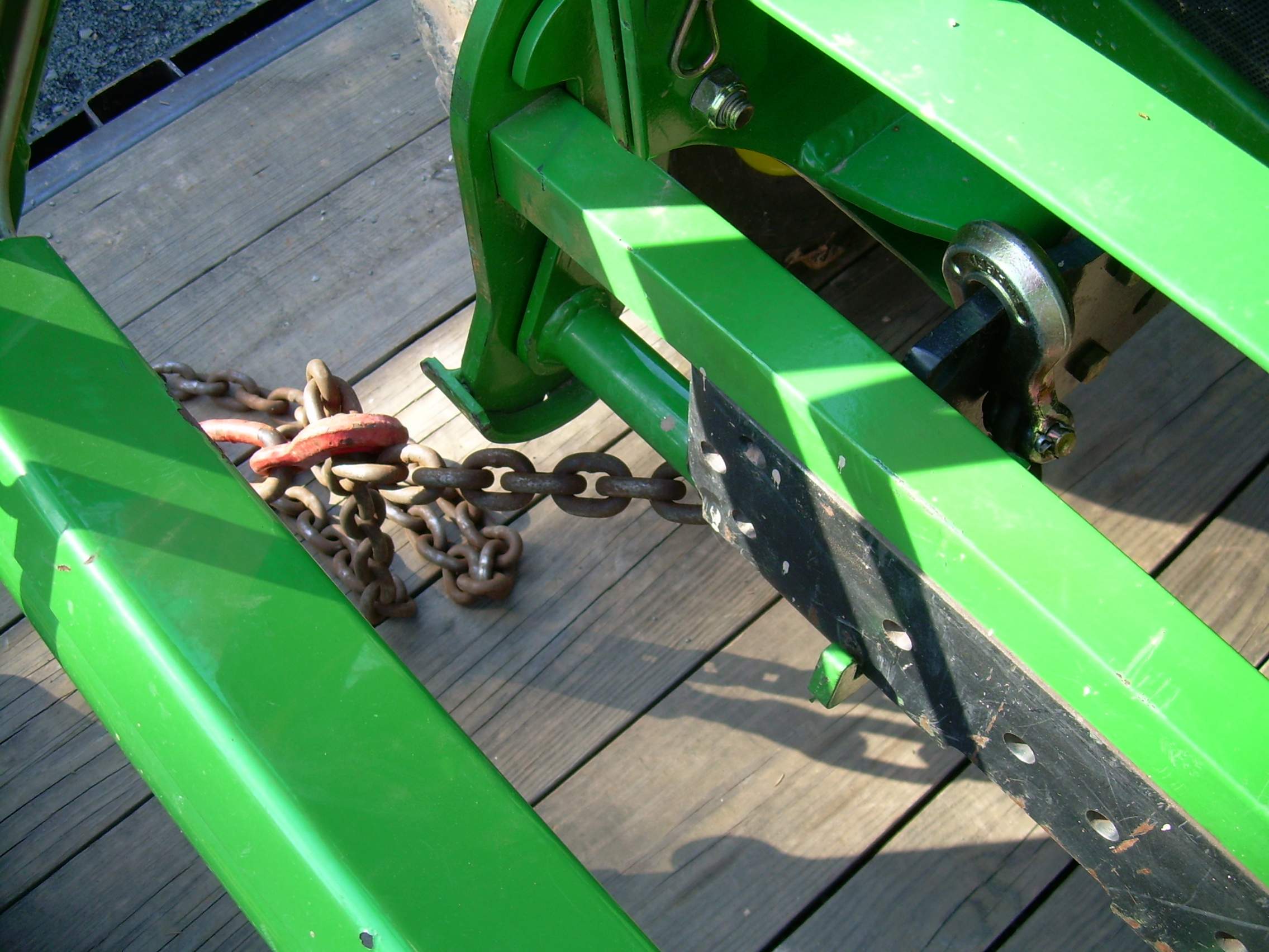

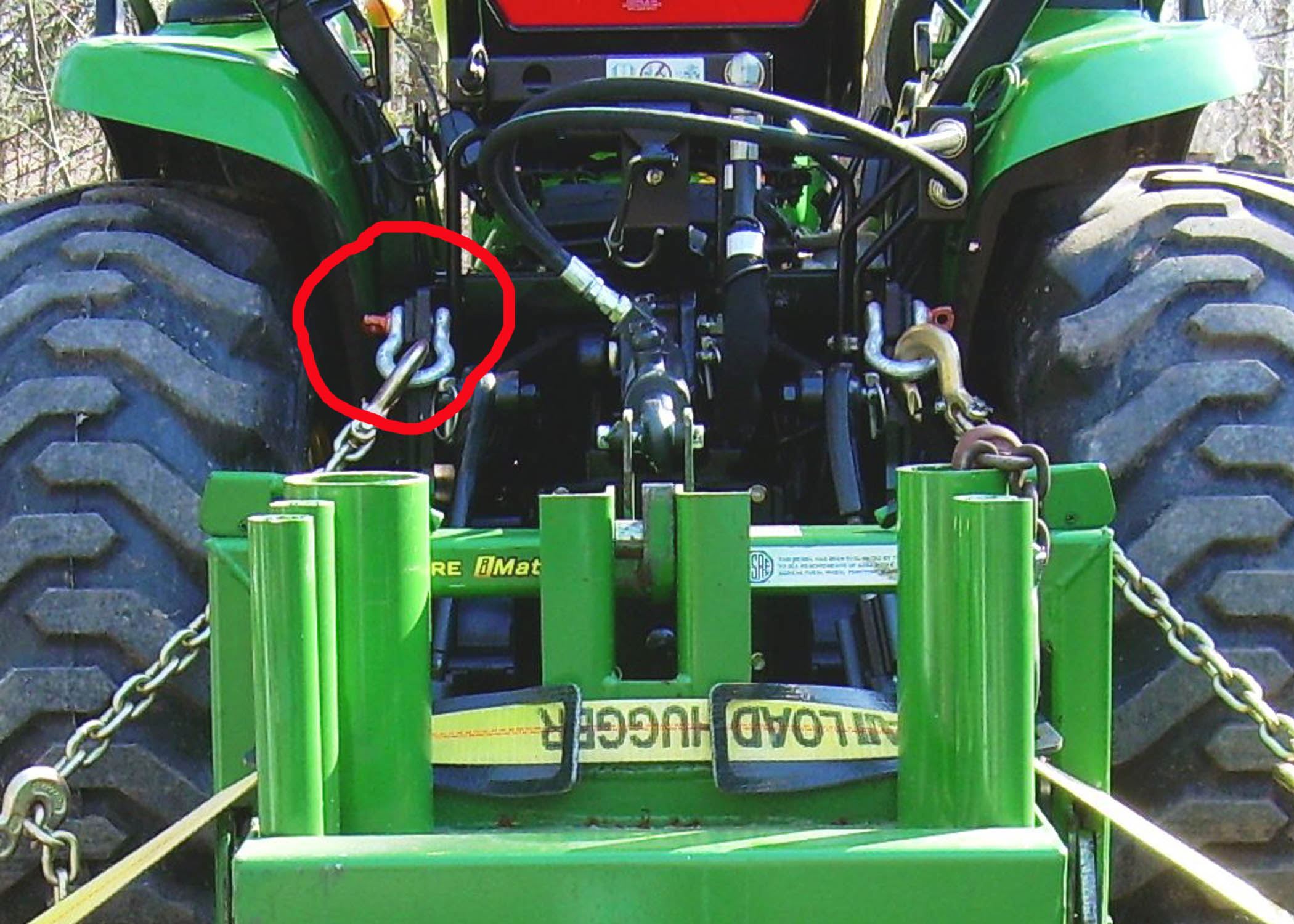

JB4310,
In the "Why four binders" thread, you posted a couple of pic of your JD chained to the trailer. Two questions:
What are the front chains attached to?
What is the attachment point for the shackles in the rear?
Thanks,
-John

I'm not JB4310 but the front is a weight bracket bolted to the frame and the rear I don't know my 4310 does not have those but should.

The back attachment points are his backhoe frame with clevis's in the top mounting holes.

I was thinking the weight bracket in front, but wasn't sure. I would have never figured out the rear was a backhoe frame.
Thanks guys!

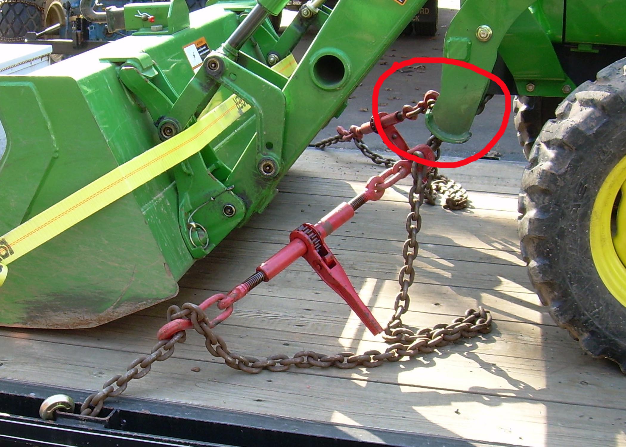

Sorry, I just noticed this thread, yes the back shackles are attached to my back hoe frame, those are 5/8 alloy shackles rated at 5 ton WWL. I don't know where else I would connect to on the rear of this tractor, where are other 4310 owners connecting to back there?
High Capacity Anchor Shackle w/ Round Pin - 10,000 lb. WLL - 5/8 in. - Mfg# M351AG

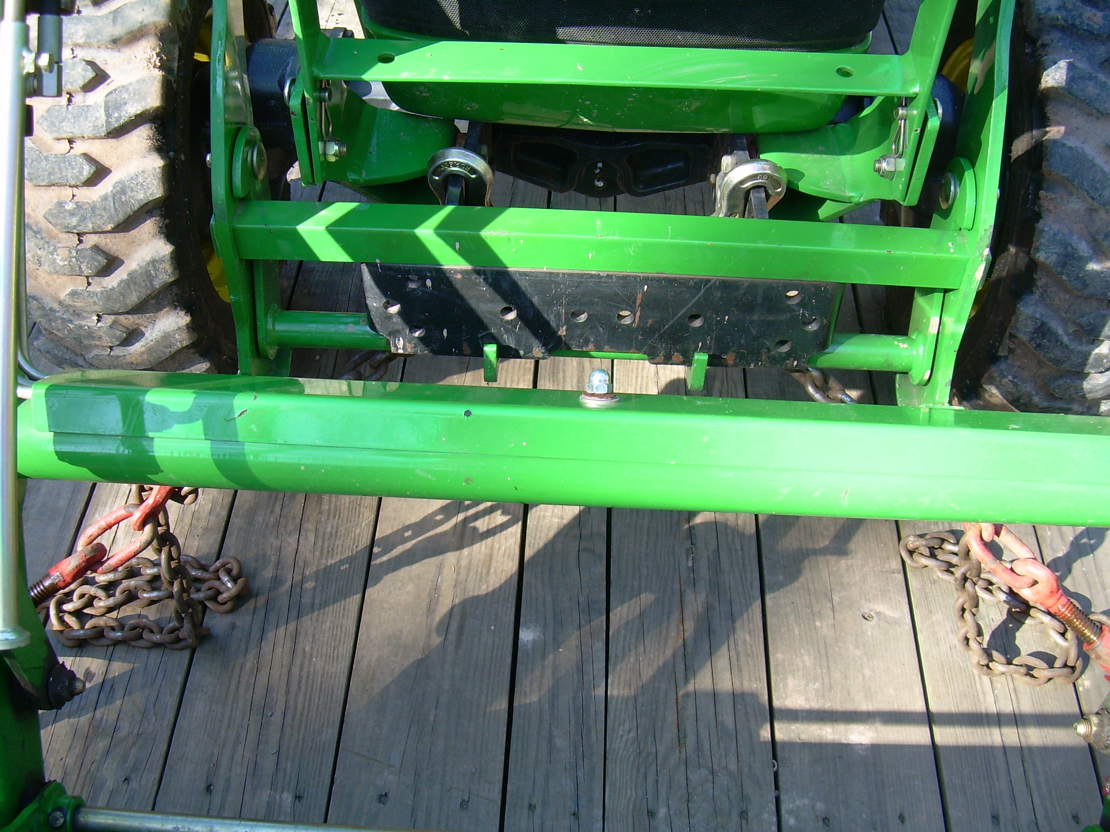

The front is hooked right on the frame behind the weight bracket, I don't think it's bolted, I think it's all part of the frame, not sure though.

Thanks for the pics JB.
That front frame location is going to get another look on my tractor the next time I haul it. For the rear, I don't have a backhoe frame, so until I see something that makes more sense, I'll continue using the draw bar.
