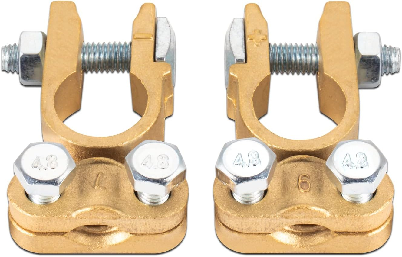

You don't need to replace the cable if the insulation is intact. There should be enough length to cut the battery terminal end off, trim an inch of insulation off, and install a new clamp on terminal. I suggest buying a set of brass terminals like in the below picture. For the ring terminal end grab some fine grit sand paper and go to town on the terminal and the copper bolt on the starter. They will clean up quickly. If the copper of the cable is oxidized you can use vinegar and baking soda to clean the wire before clamping it down. Now I do recommend upgrading the ground wire from batter to chassis. The oem one is too low gauge.

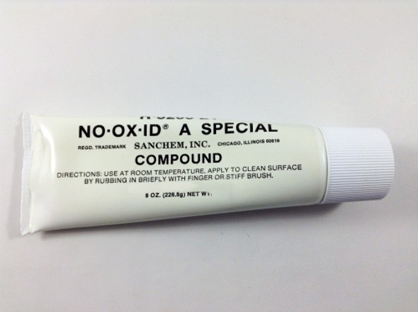

Don't screw around with funky repairs, get proper new cable from online or FLAPS sources.... Funky repairs will only come back to haunt you at some time when its most inconvenient for you...
THis is the best stuff ever.... Never had/have a corrosion issue when using this.... One tube will last a lifetime... Only caviat is you have to have clean battery/cable terminals to start with...
