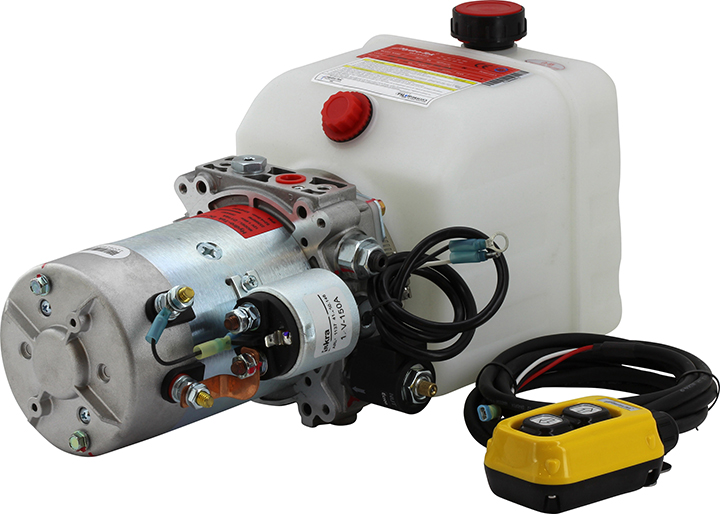

Just bought a 4x8 trailer with a hydraulic power pack . The seller told me that the dump has problems to dump the load if the load is humped up at the front But if humped up at the rear will dump the load . He was using it to dump loom . So my question is what allows a dump to dump more weight? Is it the cylinder ? I look on line and see all the different sizes of cylinders. They all seem to have the same ratings only the lift lengths are different. If I remove the power pack and rehook to the tractor rear hydraulics will it be stronger?
Best I can tell its a hydro Tek single action . Not the exact unit but a little older Might even be a double action as it makes noise when lowering but don't think its hooked up to power down.

Cylinder diameter, pump pressure, system relief valve pressure, linkage geometry, how far forward the pivot pin is on the bed and load distribution (which you noted) will all affect maximum dumping load.

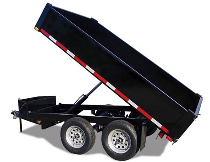

You didn't mention the trailer or loading depth, but a 4x8 trailer with around a foot and a half of gravel has a load of about 5000 pounds. Not many 4x8 trailers are built for that.
Please post a photo of the trailer with the bed raised so we can see the trailer, cylinder, and dump geometry.
For example, here is a 5x8 dump, 5200 lb axle, 1800 empty, for 3400 lb capacity (disregarding tires). It has a 3 inch cylinder.
About 10 inches of gravel would be maximum capacity.

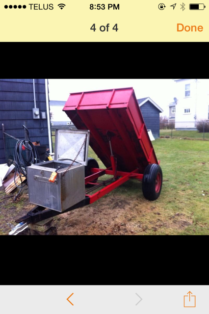

This railer is very well built and super heavy. Takes two men to lift the tongue it will have 2 new 9.5L x 15sl balloon tire this week.

It looks like the cylinder is positioned so the force at the beginning of the lift is trying to push the bed forward, not up.
Depending on your hauling situation for this gravel, you might put a temporary block under the front of the bed so it doesn't come all the way down. That would give the cylinder a better start for dumping.

Yes the cylinder lies flat and tries to push the box forward until it lifts.

My dump trailer does the same thing. Just a couple inches of boost with a shovel is all it takes to get it lifting. A block to prevent it from dropping all the way would work I'm sure, I never thought of that.
