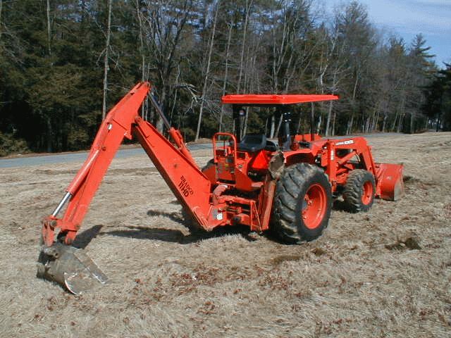

Sorry for the long reply - but you asked about my favorite subject - L3's. In the '90s this series became the L4350, L4850 and L5450 (pic of my rig attached)
Take care, Dick B
