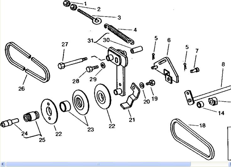

When they explained it "stopped moving" I would first suspect that the variator stopped working, and that it isn't the tranny. They can get out of adjustment and also hang up when not used very often. They are fairly easy to work on.
Should be worth $500, in the non-running "condition" it is in. Might get it for less, but not if someone else knows the problem and how easy it is to fix. If indeed it is the tranny, then a replacement should not be hard to get. I'd expect they can be found in working order. Those were pretty solid tranny's. I see it as to your advantage that they indicate a tranny problem.
The Kohler engine condition would be the biggest worry. And it sounds like that is ok.
I had a JD 212 and it was a very good, solid lawn tractor. Likely it doesn't have hydraulics, but the speed variator allows you to vary the ground speed in any gear without changing the rpm of the motor.
Here is a schematic of the variator parts.
I sold my JD 212 for $500, and have seen them (and JD 214's) sell for $1000.

agreed. About 500 bucks and the variator is the first thing to check. There are two drive belts on it. Also, if you move the variator with the engine off, the thing won't move until you fiddle with it a bit. I have a 214 and a 112. The transmissions and drivetrains are nearly identical.
There were tons of Deere and aftermarket attachments available for the 214: mowers, tillers, blades, sickle mowers, bagging systems, sleeve hitch attachments, snowthrowers, 540 PTO, etc.
Parts are available and the 214 is built better than anything you will find on the market today in it's class.
