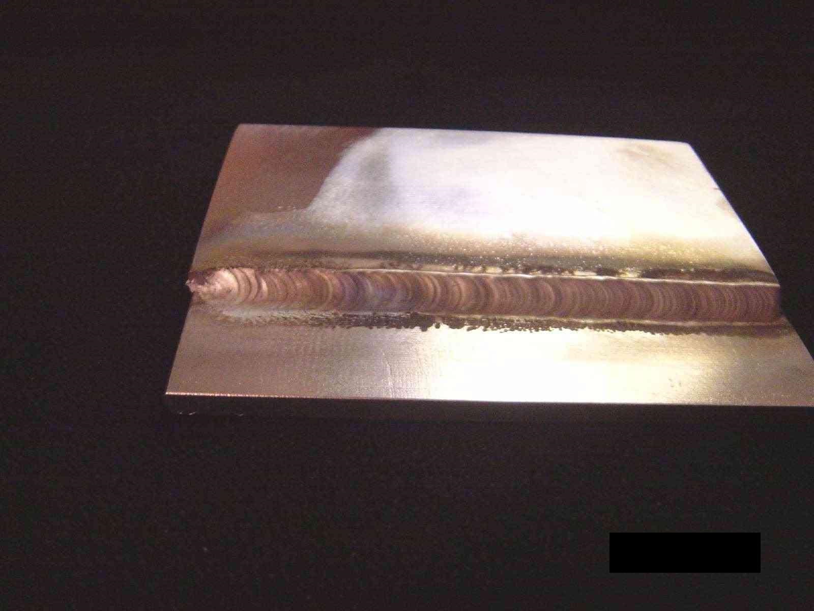

This is an aluminum Tig weld made on DC, with 100% helium.
Show Off!! Looks good man! :) The first time I tried DC and UHP on some 1" aluminum I couldn't believe how much penetration I had with relatively low amp setting. Takes some getting used to though, no shiny puddle like with AC..

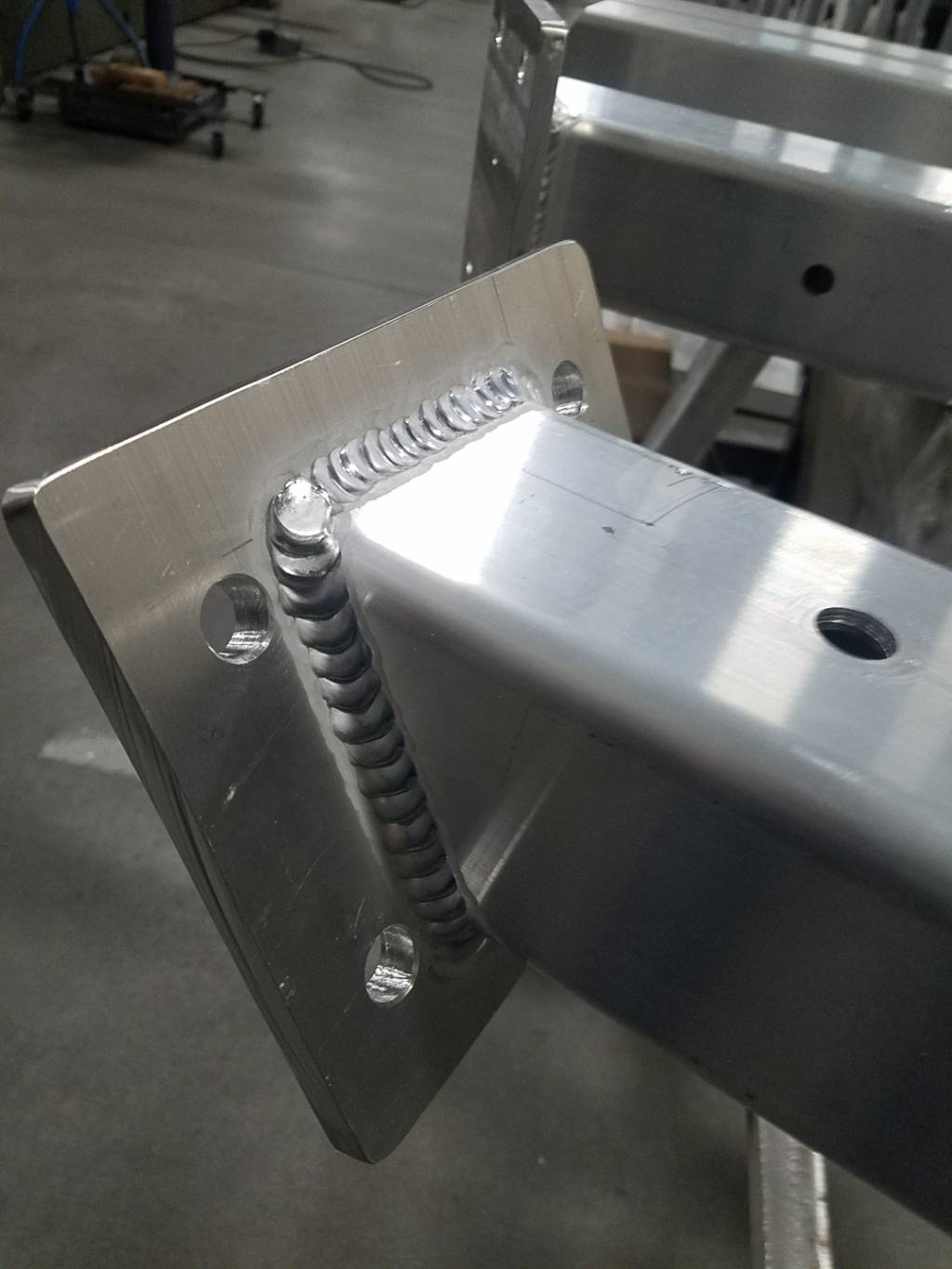

   / Question welding aluminum #10
I have a Everlast 200st with Tig/Stick function. Granted I think it has a very generic Tig function but it's welding aluminum is not something I would do often at all. So my question. Should I just get a Tig torch and use what I have or invest in a mig welder? Seems whichever way I go I need gas which I wanted to avoid since I would rarely ever use it, but looks like that isn't an option.
Thanks
Edit*. This would also be something I could use on thin steel.
Invest in the tig set up. I do this at work. I need to get a better machine for home use for side work. 20180523_103643.jpg20180518_114706.jpg
