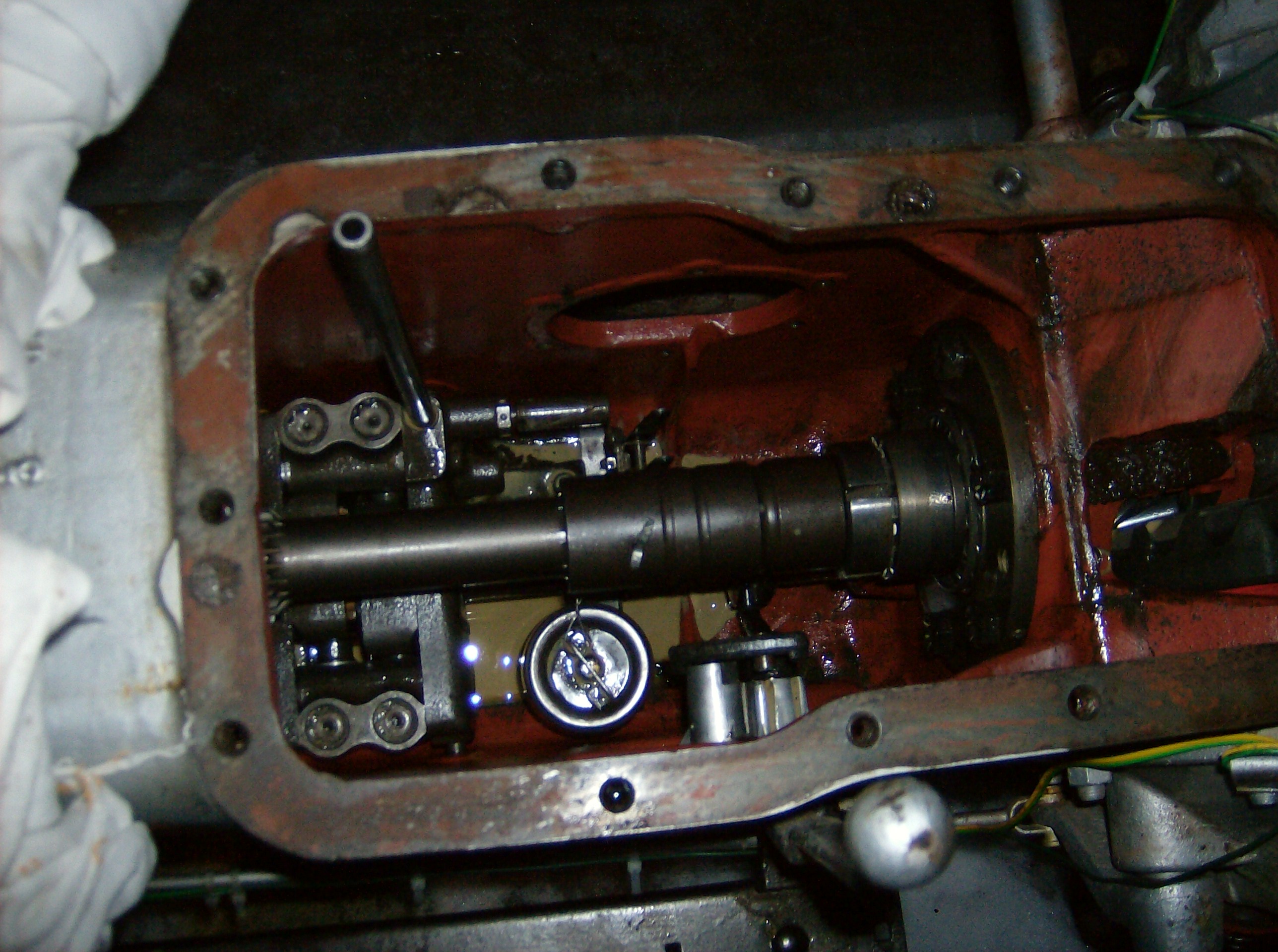

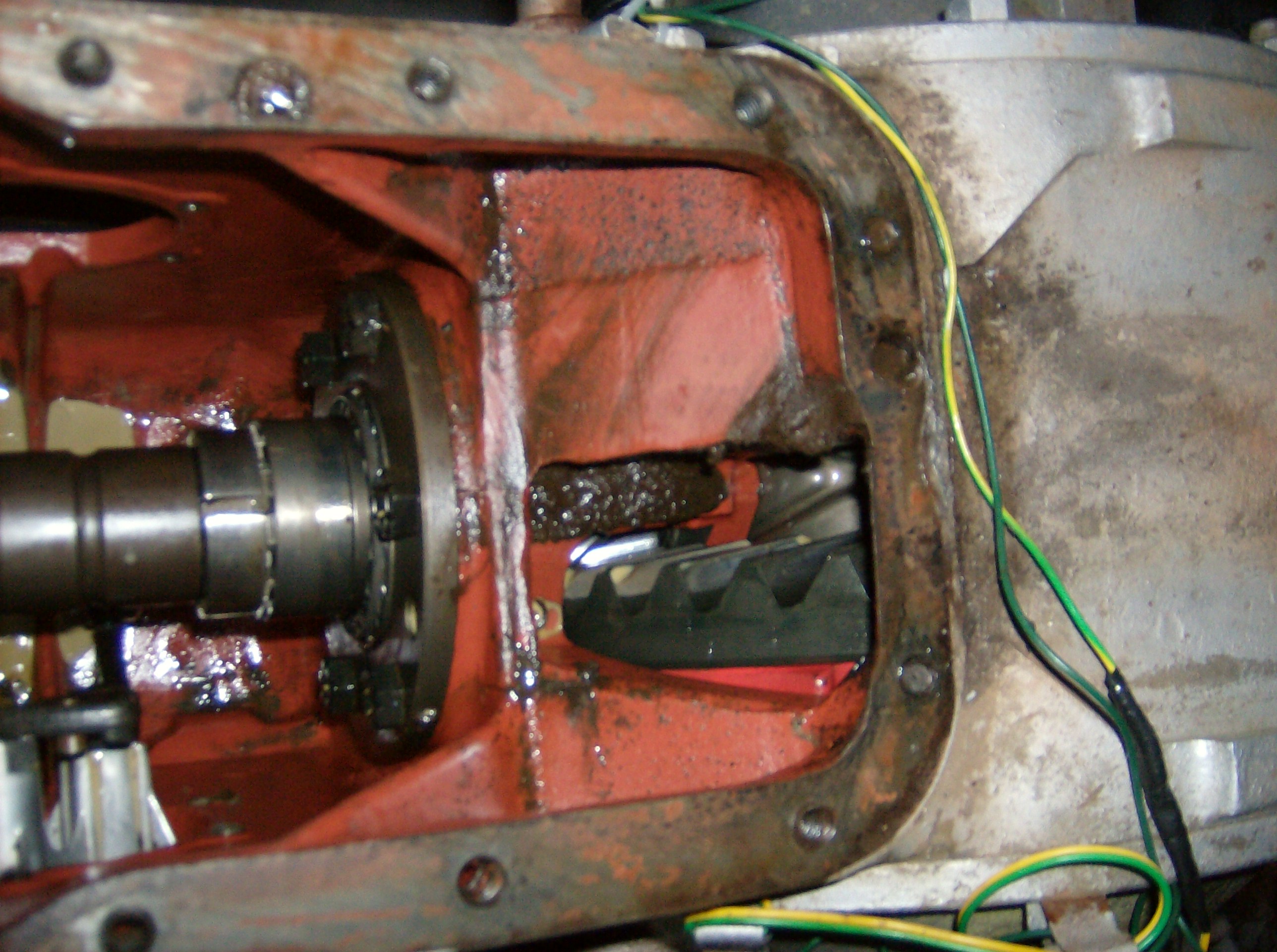

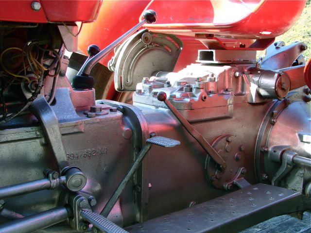

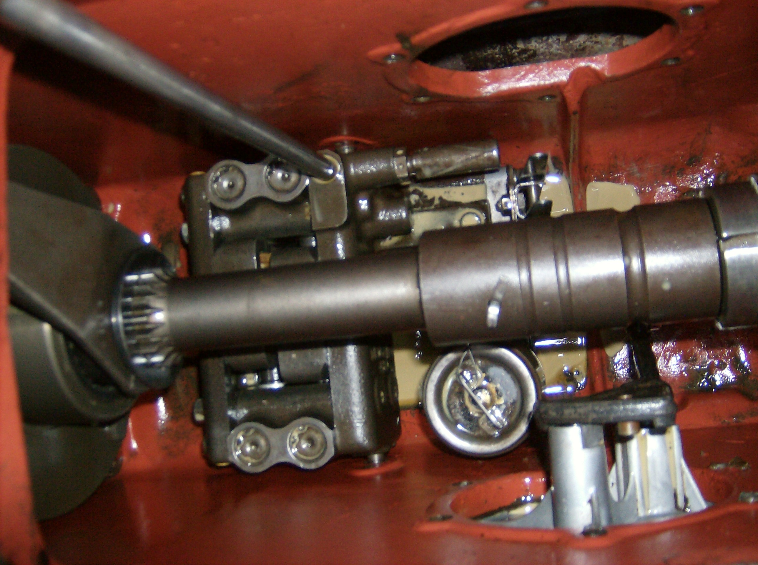

The photos are of my 66' 135 hyd case. The second photo shows the lever and how it is attached to the collar that has internal splines. By selecting the lever the collar (three grooves milled in it) slides on or off an external splined shaft to engage / disengage the PTO. Throttle / clutch is used to control how soft the PTO will engage.
Hope that helps.
