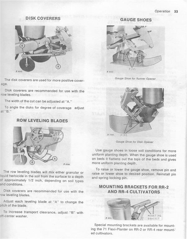

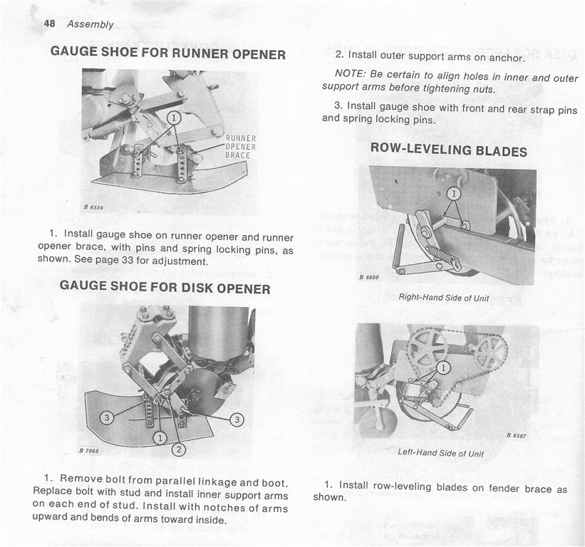

Need some help. Anyone with an original copy of the JD Flex 71 planter manual please respond. Does the manual show any installation pics or instructions for the gauge shoe's? I have the Yetter manual but they don't show anything or mention anything about the depths shoes. I'm referring to the "skid" type not the ones that mount on the disks. I've searched high and low for pics of how they mount and can't get anything clear enough to go off of. I for the life of me can't seem to get them on correctly. If anyone with them on their planter could help out that works too, lol. Any help would be apprecitated. Thanks.

Here's what's in the manual
Good luck
   / Question on Flex 71 planter manual? Need help!
Thanks flusher. Just what I need.
