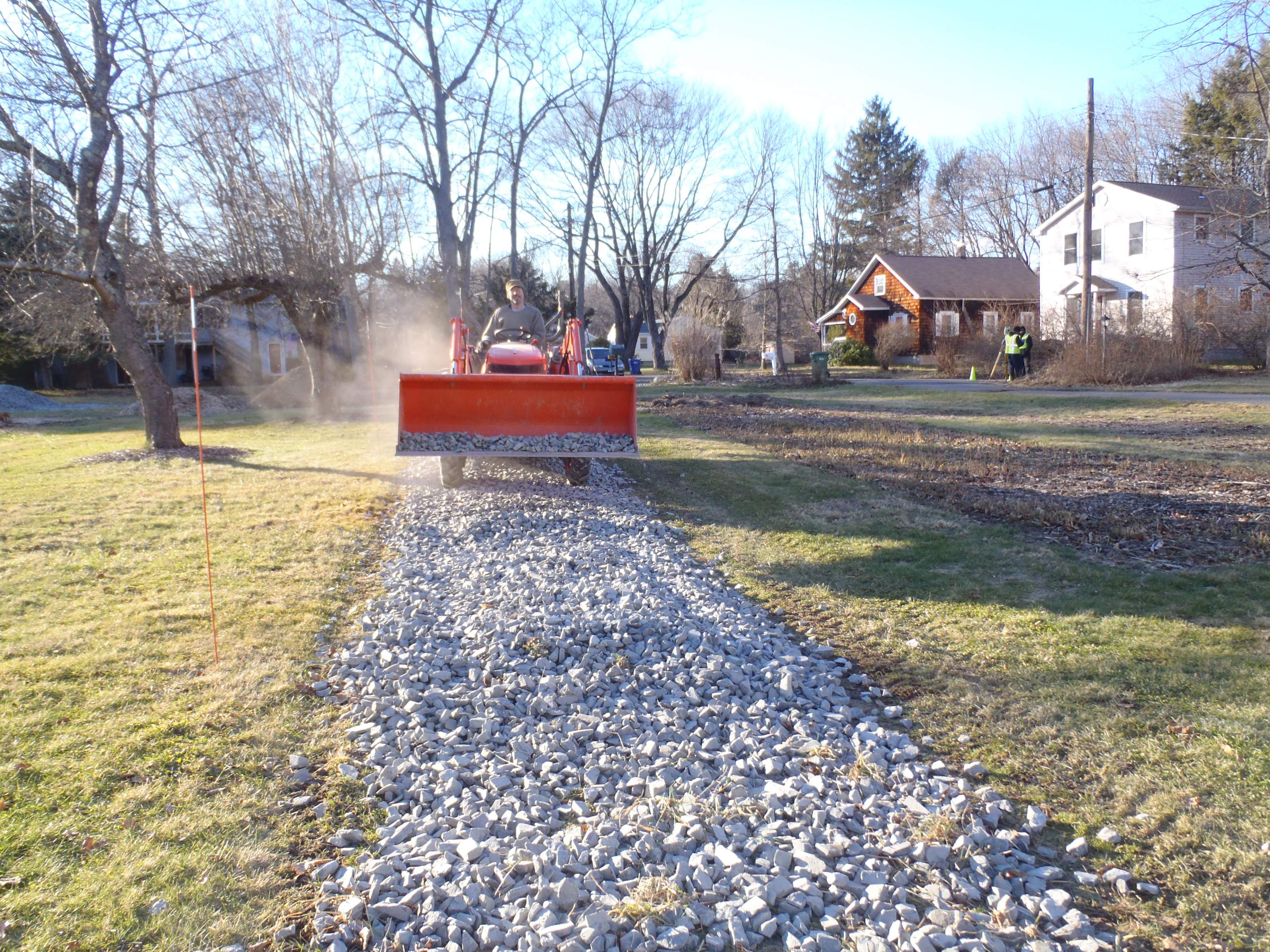

I need to get my parking pad in front of the shop squared away. I'm planning on just a gravel pad. The topsoil is off and the soil is stable, I just need to know the order for my gravel. Planning on two layers. Is it crush and run on bottom and 3/4 on top, or do I make the 3/4 the base and finish with crush and run on top?

I'd put #3 (not 3/4) on the bottom and then crusher run on top. Assuming you want a smooth surface that is -- hard to tell based on what you're asking.

I just spread a tri-ax load (44,700 lbs) of ASTM #3 (2") down to stabilize a high clay area that gets soupy in wet weather.
Hoping the freeze/thaw of winter and frequent driving over it will help pack it in.
I'm pretty sure it's going to take additional filling and raking each time we get a thaw and the gravel sinks in.
About 1/4 of the stone remains in the pile to be used as filler for any low spots that form.

I don't know about all these weird gravel names, but for my yard - - I put 2" crushed & screened rock down for a base(6" deep) and rolled the crap out of it. I followed this with 3/4" minus (screened - nothing bigger than 3/4" and including down to 10% sand & silt mixed in) spread and rolled. This has provided a very hard stable surface.

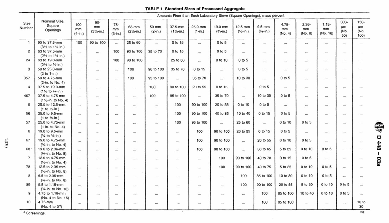

I looked it up to see what people are talking about. Here is a table of standard sizes. Save it so you can translate those numbers.

There certainly are alot of different sizes and different mixes. But not everywhere calls them the same thing and not everywhere has everything.
IE: on that list, #5, #6, and #56 stone isnt even heard of here, and are all VERY similar to #57's

Point is, you need to call your local place and see what they carry. If you tell them you need ~3/4" driveway stone, they will know what to bring you. And for your area, that may be #5's, #6's, #56's, or #57's.
IF you need driveway base, tell them the ~2.5" or so sized stuff for base material. They will know.
