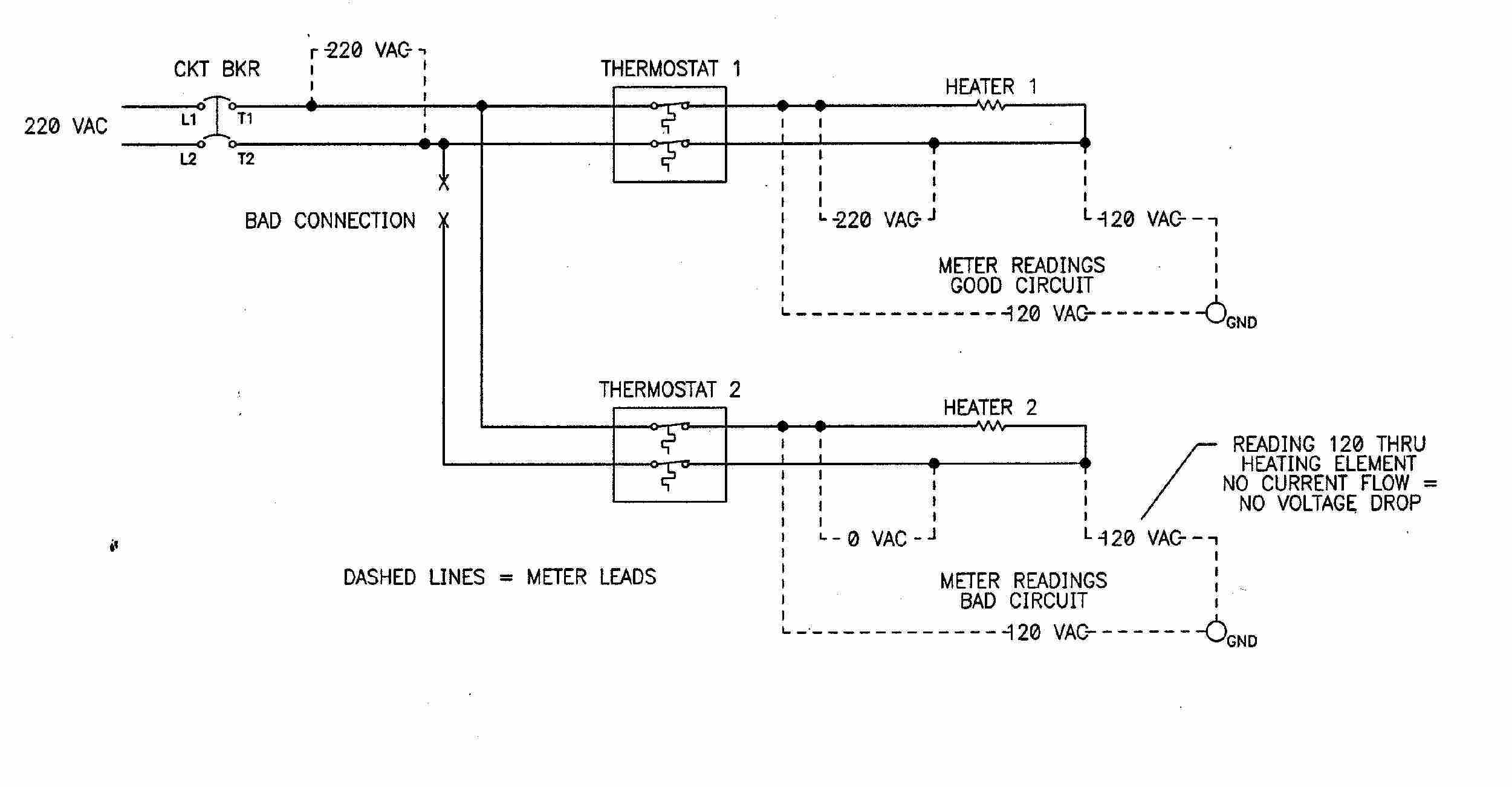

I have a room that has been heated with 240v electric baseboard. It stopped working. Without testing I replaced the thermostat. No change. Replace the heater, no change. I did get zapped changing the heater. No comes the part I don't understand. I used a voltmeter (cheap one), I can measure 120v between either leg and ground but between the two legs nothing. The heat was working very recently, another baseboard in another room connected to the same circuits works great. Any thoughts?

Sounds like you lost one leg of the 220. Maybe bad breaker, bad connection, etc. If one leg is open from the breaker, it would still read 120 VAC on each leg because it would be reading it thru the heating element. Check the 220 as it comes out of the breaker. If it is there, then check all your connections thru out the circuit.
Oops. You said it was on the same circuit as one that works. So carefully check all connections in the one that doesn't work. If the two heaters come from the same circuit, then there must be some connections somewhere tying the two together. See if you have 220 at that connection point.

Like someone else has said, this is true only if the heater isn't hooked up. If the heater is hooked up, the two hot legs are tied together through the heating coils and you will read 110-120 volts even if one leg is not connected to the breaker.
   / Question for the electrical experts #6
Let's see if this attachment will work. A circuit that sounds like yours. Shows one good ckt, one bad ckt. Dashed lines represent meter leads and readings.

Thanks for all the replies. So it sounds like a "break" at the junction splitting to the two rooms. Great, its in the attic with a little access hole. Can't imagine how that happened. They were wire nutted and taped (at least I think I taped'em). It was about 20 years ago.
