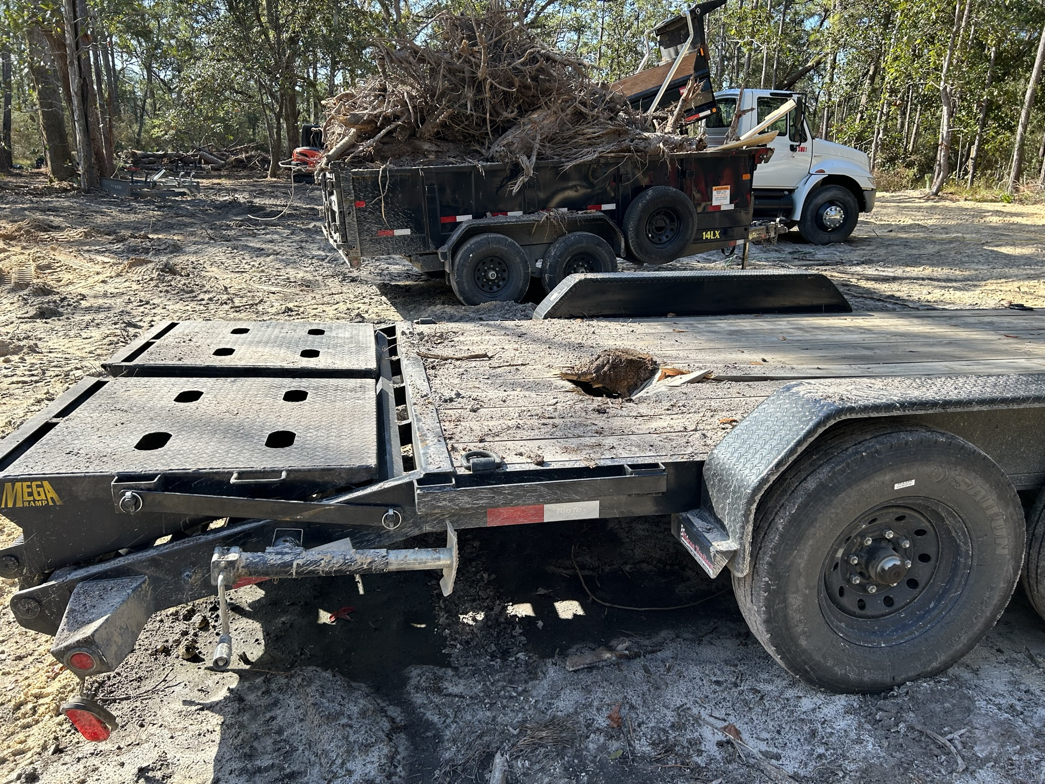

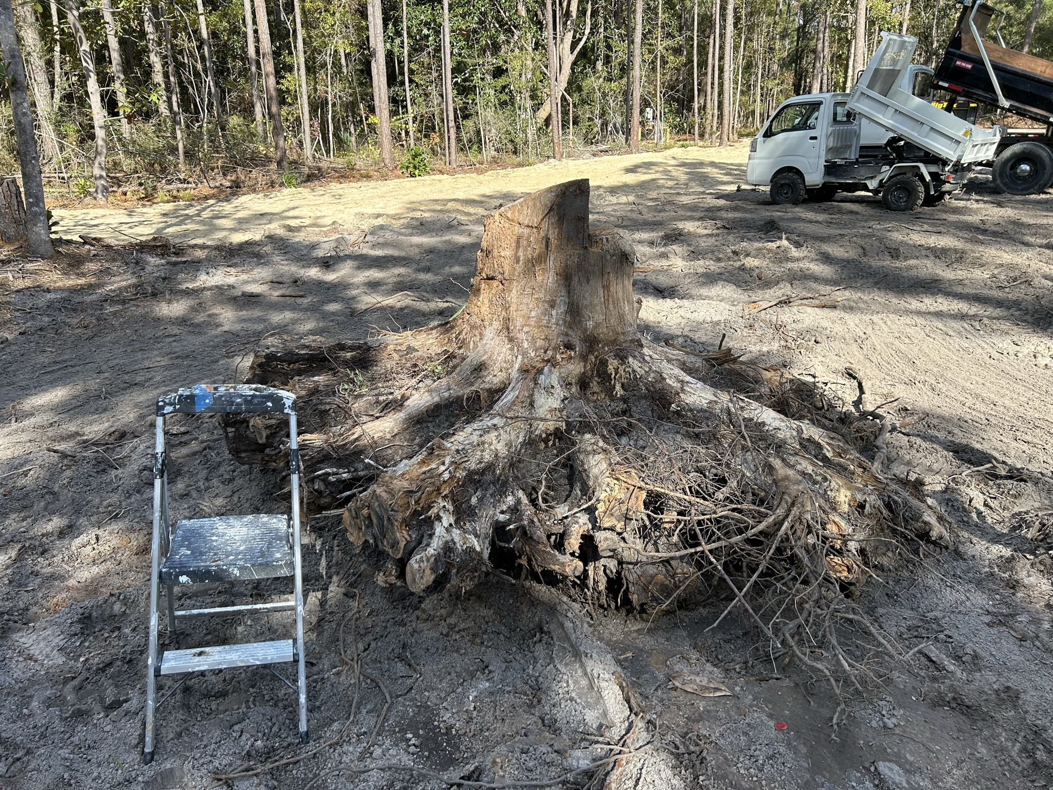

Last week I was trying to load a stump and root ball unto my flatbed trailer using my KX-040 and my SVL 75.
It got away from me during the loading process…….
Oops!

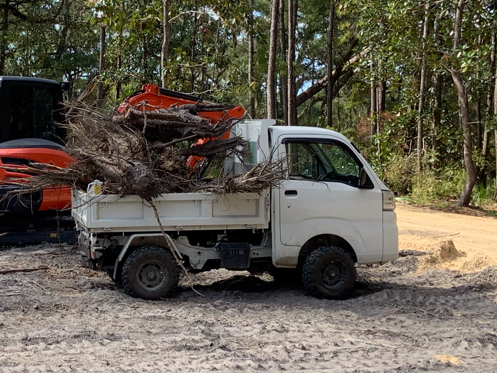

It happens! I've been using my M59 powered forks for moving the root balls, works better than my grapple.
I like your mini-dump-truck! I now wish I bought one years ago as a UTV when they were cheap and new in our market.
That little thing is a beast.
