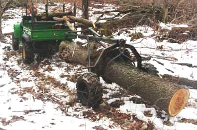

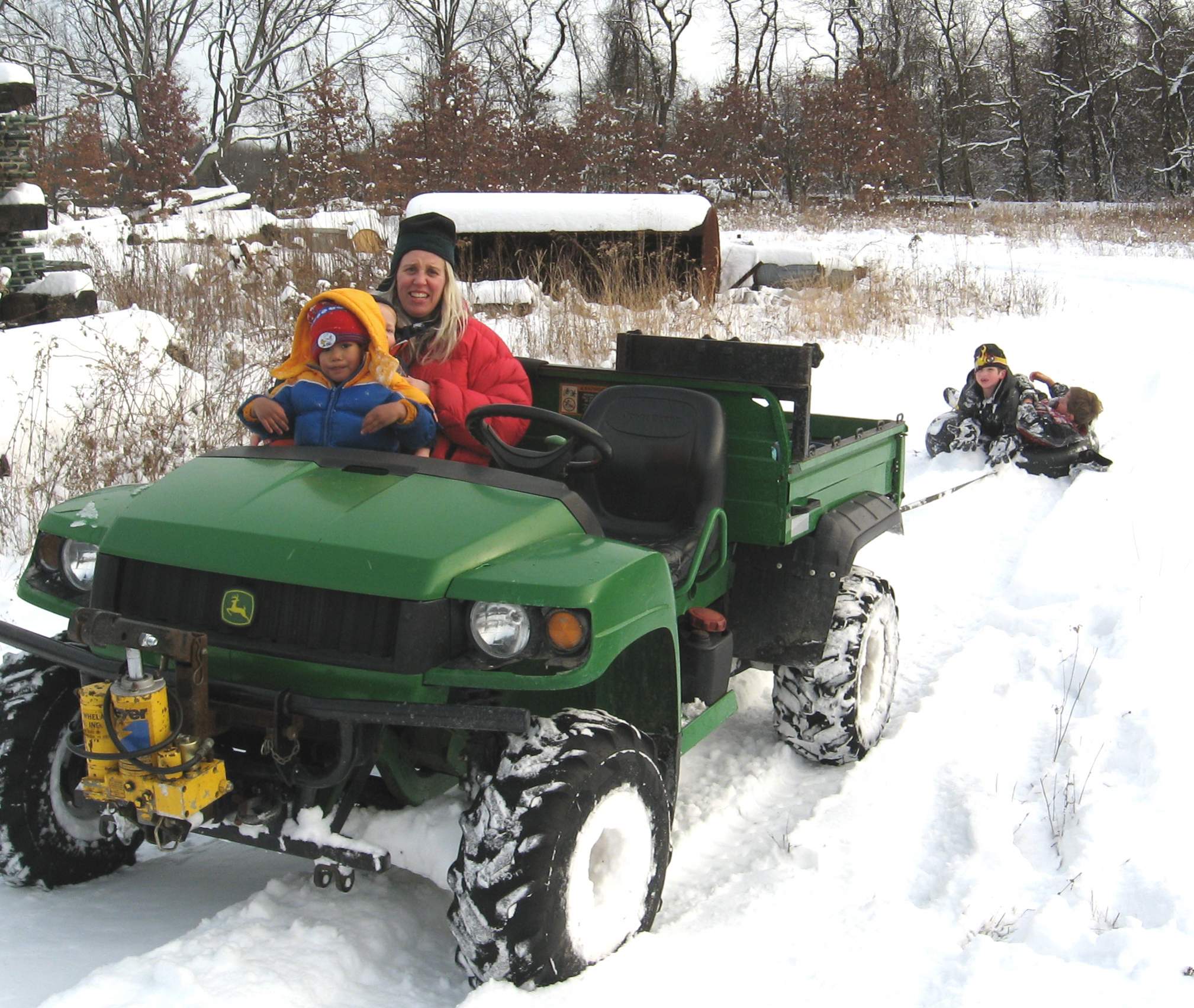

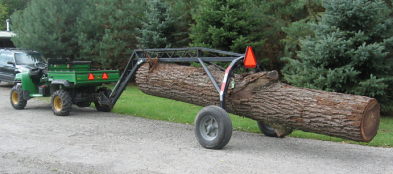

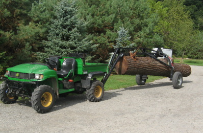

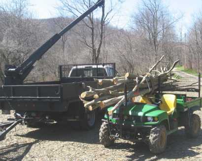

I have had one HPX gasser, and now a 2005 HPX diesel, 900 hours currently (my buddy traded it in and I got it back from the dealer, same with the gasser). The gasser would put fuel into the gearbox, and about every 40 hours PUFF, big cloud of smoke, so crank case full, change oil. Dealer said common on "short runs" as engine never heated enough to burn off excess fuel, I say bad fuel dellivery. Anyhow, LOVE the diesel. Mine does NOT have independent rear suspension (IRS), nor would I want it. I haul heavy =1000 or so pounds of wood up high on a custom raemovable rack and want SOLID feel for the off angle stuff. I retroed a Meyer 6' power angle plow and it performs flawlessly, stays under a carport in all season and has NEVER let me down. My acreage is 3/4 off the road and 50-150 up in elevation. I did find custom 12" rims (before only 10" available) to be able to run skidloader tires. Been one H$$% of a machine here on my 15-20 acreas and for my business in the bush. Pictures show Goodyear Runflats on 12" rims, I now use skidloader tires. I will look for some more pics. OGator@windmill4.jpgOIMG_0177.jpgoskidmorewalnut7.jpgoSkidmorewalnut8.jpg

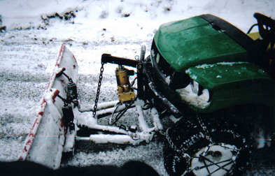

Second pic shows tire chains on original rims on my gasser, not needed with either the runflats or the skidloader tires. I was hauling HEAVY arched logs out of a slimey woodlot skidder trail that day. Plowing they are not needed. We had 52" of snow one Febuary and that little sucker plowed like a champ. I am tired of being out in the weather some graduated to a F-550 V10 with a 9' blade, Git'er Dun!! Gator is my "backup" plow vehicle now. I did put the heavy duty spring up front once they became available, they are recommended for cab installs and such.
