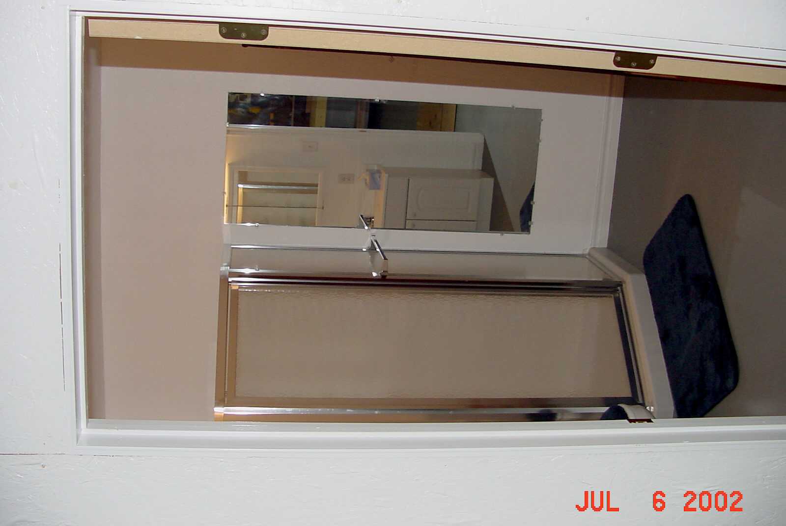

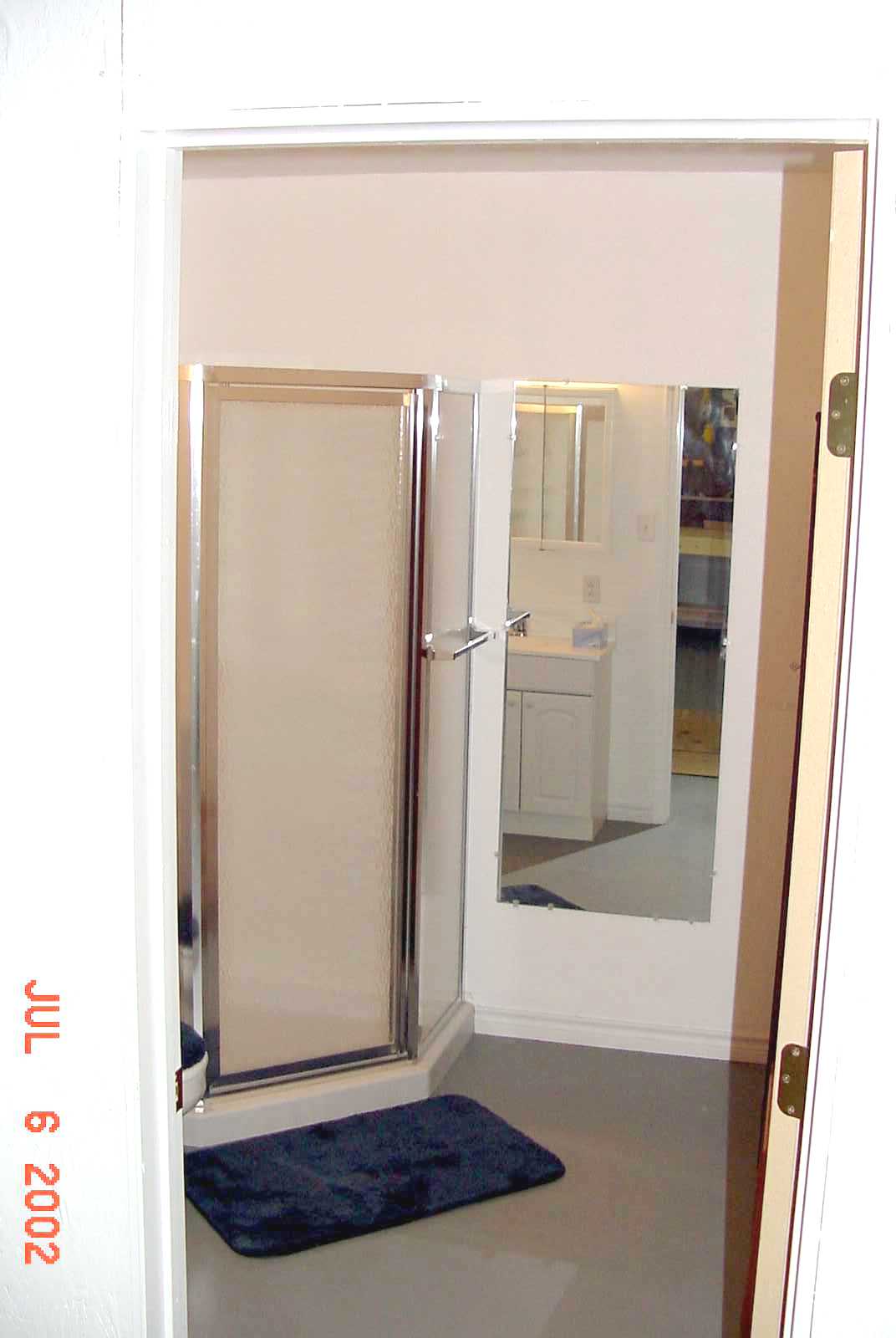

Mark - I put up a 30'x40 metal building 5 years ago. I had a concrete contractor do the slab, but I roughed the plumbing myself. Even though I had never done that before, I wanted to make sure everything was where I expected it to be. I put in a bathroom with a corner shower unit, a commode, and a vanity. On the outside of that, I put in a kitchen counter/sink and cabinets with a water heater closet beside that. I went to HD and carefully measured everything to make sure how far from the walls the drains should be. My water came up thru the slab into that common wall so I had to have that and the drains pretty close to exact. Ended up working out very well.
Attached is a picture of the outside. Pardon the tractor parked in the kitchen. /forums/images/graemlins/grin.gif
