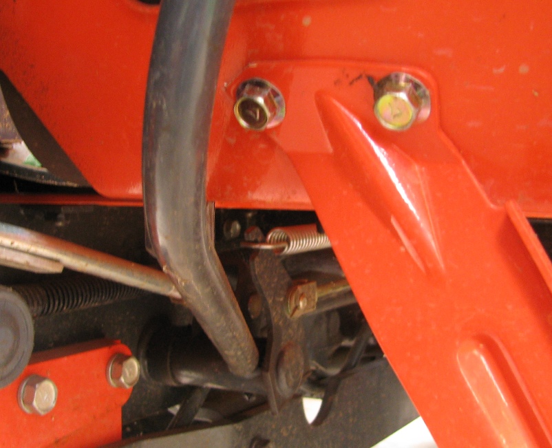

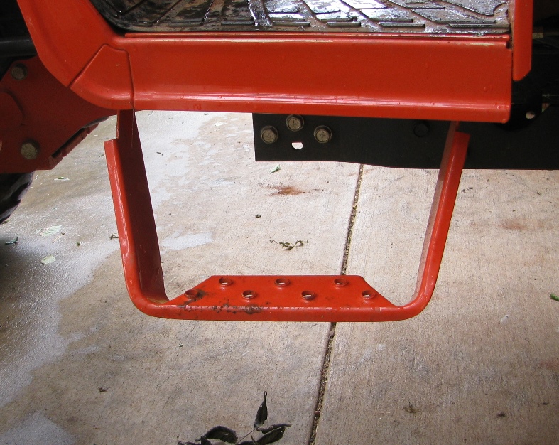

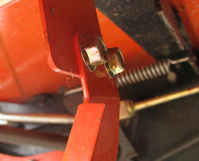

Jim,
Here's some pics of the step that I added on my B3200. One pic shows the front mount, next to the clutch pedal. Another shows the rear mount up under the fender. The final pic is an overall view of it mounted. If you have the threaded nuts welded to your running board, this might work. the space from front to rear is a little under 12" and the step can be bent a little either way. I believe mine is from a B3300. I'll run down and pull my file. I might have the part number.
The p/n is 6A700-51350-620. I got it from Coleman for 24.72 plus shipping.

John,
Thanks for taking the time to post your pictures and give the info. I don't think I have any threaded bolt holes, but I'll take another look.
Jim
