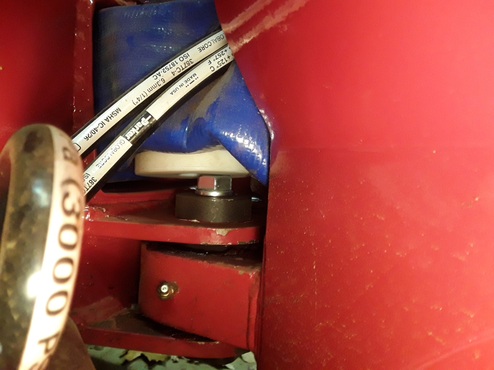

A rainy day here in CT so doing the 8 hr interval greasing on my 1460 and checking the center pin torque (pic attached if you have never seen yours).
It has 24 hrs on it and it is the first time I noticed it has grease fittings on both sides of the lower center pin boss (and only on the right side of the upper pin).
Now logic tells me the grease fittings on both sides can't be for convenience, So it must need grease from both sides. Has anyone talked to PT on this?
Also out of all the loader grease fittings, two would be hard to grease, so I rotated those 180 deg, now they grease easily.
