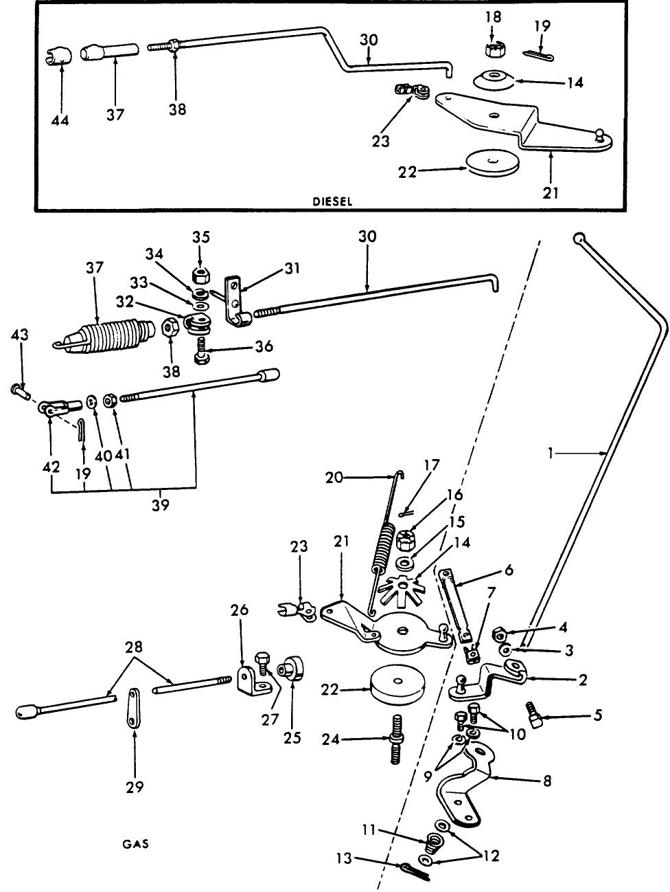

I noticed the spring was broken that fits on my carb linkage (861 Ford) and I bought a new one.
But I can't figure out where one end attaches?
The "Long End" connects to a hole in a plate on the linkage (right under the Air Cleaner), but where does the other end connect? Anybody know? It goes somewhere under and close to the battery tray I think.
Thanks- Dennis

seems like i posted a reply to this somewhere.. did you double or cross post this?
there is about a ?? 8" spring from under the bat box, passingthe bellcrank to a rocker.. etc. is this the spring you are looking at? 8" may be wrong.. I'm going from memory.. tractors are at the farm and I'm at work... whodat or rickb can verify..

Yes - the spring is about 8 inches long...
I will connect it to the tab under the battery box!

here's a diagram of the linkages too, in case you dind't get them. don't show much.. but if you pulle dit apart it will help you get it all back together..

Yep, that's the diagram I ordered spring from - it's # 20...
Thanks, Sound Guy, for your help... Much obliged!
