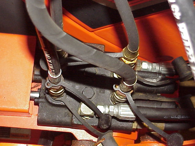

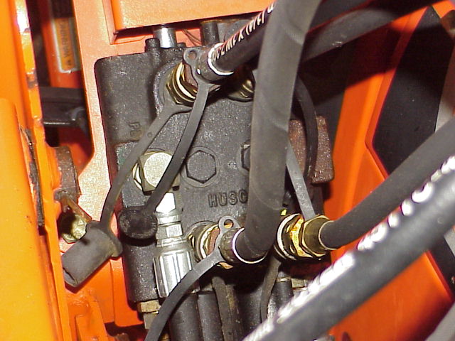

I have a Kubota loader LA301 with a joystick/valve
can anyone tell by the attached pictures if I can tap into this valve to power a grapple bar for the loader bucket?

Yes, you can. The port marked "PB" stands for "power beyond". You would take that line off then:
-From the PB port on the FEL valve to the IN port of the new valve
-The PB port of the new valve would connect to the line you removed (it feeds the 3PH)
-The OUT port would get Tee'd to the OUT line of the FEL valve-basically dumps back to the tank.
Search the term "power beyond" here in the hydraulics forum...
the "out" port of the new valve? there will also be ports that connect to the grapple cylinder onthe new valve?
   / question about FEL valve #4
You need to install a new valve to control your grapple correct? Tell me exactly what you are wanting to do...
