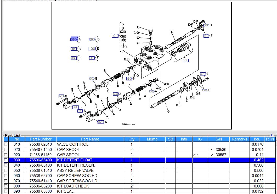

My loader valve has a float detent that has quit working (won't stay locked in)...so I've ordered the parts...while doing the research for the parts I saw a "detent regen." (regeneration) also listed...my valve does not have this but I was wondering what it does and when it is beneficial to use ?

Thanks for the reply...but I'm still not sure of the benefits or how it would be used:confused:
If it's a detent what happens when the joystick is set in the 'Regen.' detent position ?
FWIW here is the blow-up
