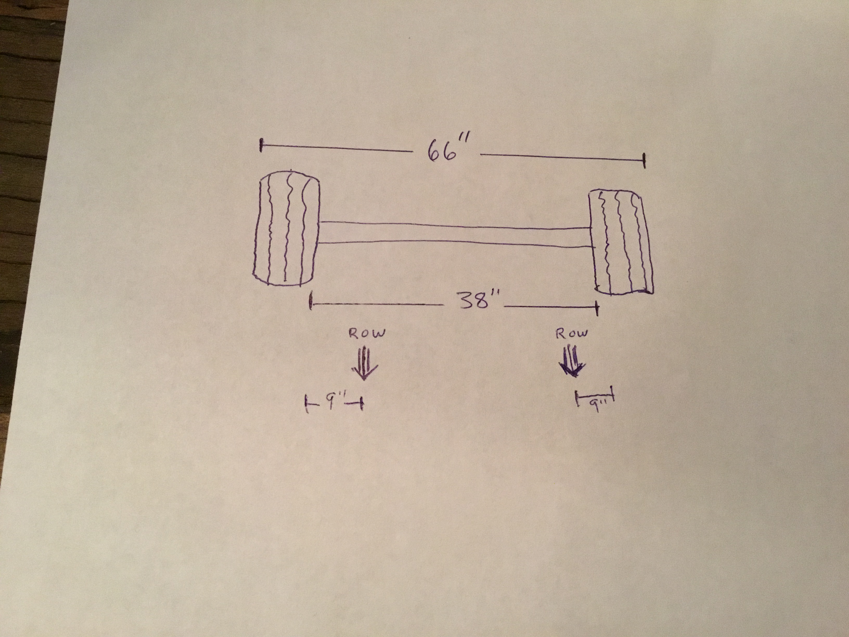

My tractor/ tire width is at 66" and tires are 14" wide on rear with no adjustment. So if my planter is centered to tractor my row spacing would be 66".
So if I'm understanding this right , is that if I move planter over to the side just 9" inside rear tire then I could make 2 passes in same tire tracks giving me 2 rows leaving 20" in between rows.
And if I buy myself a 2 row cultivator and adjust feet to cultivate each side of row and be able to mount a side dresser in the center with 2 fertilize chutes and that the press wheel will ride between the 2 rows ???
Does this sound about right? Or am I way off?.... please advise

There are problems with planting corn at that narrow of row spacing. 1. Your rear tires will will end up running over corn at 20" row spacing. 2. Are you planning on irrigating the corn? Corn is a moisture intensive crop. On 40" rows and 10 - 12" seed spacing I have to put out soaker hoses for my corn if it doesn't rain every 10-14 days at least (every 7 days is better). The higher your plant population the more moisture you will need. Also, the more fertilizer you use the more moisture you will need. Remember corn is a member of the grass family. Last year was unusual for the amount of rain we received at the right time. But, I still had to water early. I planted the first batch late March last year and then at 7-10 day intervals. Last corn was planted mid-April. I used a starter fertilizer at planting and ammonium nitrate (pure nitrogen) when corn was knee high. You would be better off buying a two row planter and going with 30-33" rows to be compatible with your tractor's wheel spacing. That would allow you to cultivate your crop and side dress with no problems. The side dresser attachment on the Covington planter does not need to be used with the planter unit. It can be mounted on a cultivator by itself. 20" rows may be fine in Iowa or Illinois, but they have a soil that retains more moisture, has more organic material, plus a climate that has a more predictable moisture delivery as well as a later transition to high temperatures.

When you compute wheel spacing it is from center of rear tire to center of rear tire. Also can be computed by measuring from the center of your draw bar to the center of one of the rear tires, then multiply by two. So I estimate you wheel spacing is 52", center to center? I would still go with 30" row spacing.

Wow- when I was looking for planters I was told I couldn't use my Kubota to plant using a 2 row planter because of width!
I will sell my Covington one row planter and buy a 2 row planter if that solves my problem. Thanks so much for your time and help. It is much appreciated
   / Question about Covington 1 row planter #9
The planter you have is fine, you just need another one and a straight toolbar cultivator instead of a single row cultivator. Honestly though, I have planted a LOT of corn with a one row setup and prefer it, especially a small field like you plan. What kind of corn are you planting?
