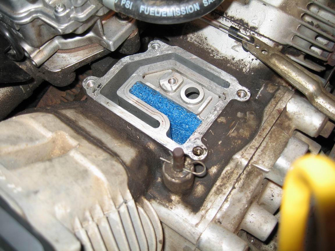

Well, I finally got around to inspecting/servicing the breather and reed on the Cub. The reed was fine, but the filter was in pretty bad shape, so I replaced it, reassembled everything, and hoped for the best. It worked great for 1.5 complete "mowings". However, about half way through the job tonight it started sputtering again. Upon further inspection -you guessed it: the breather tube was dripping oil. Something I forgot to mention before was that my back yard is on a bit of an incline, so I'm always either mowing down a hill or up a hill -rarely ever on perfectly flat ground. I never suspected this to be a problem before because I've mowed this way for the prior 6 seasons without a problem -until this year. Now I can't keep the oil out of the breather tube. Looks like it's time to route the breather tube away from the intake altogether.
Anyone have any other ideas?

Yes, I solved this problem! As it turned out the oil in the breather wasn't actually causing my problem as I thought. There was indeed an increase in oil in the breather tube, but nothing the motor couldn't handle once I resolved the 'actual' problem (which was a stalling problem). In my case I had a bad FUEL PUMP that would operate fine on flat ground but as soon as I headed up a hill and put a load on the engine it just couldn't keep up. I had rebuilt the original OEM aluminum pump and therefore had eliminated it as a potential failure mode when attempting to diagnose this problem. This is why I started looking at the oil buildup in the breather tube -thinking that a large amount of oil feedback could actually be causing the stalling problem. However, my brother (and several people here and on another websites) all felt my 'stalling' problem was fuel related and had little to do with the oil in the breather. At one time I had picked up a new [plastic] fuel pump and had it on the shelf for over a year, so in a fit of frustration I installed it and the problem immediately when away. Oil in the breather wasn't causing my problem.
