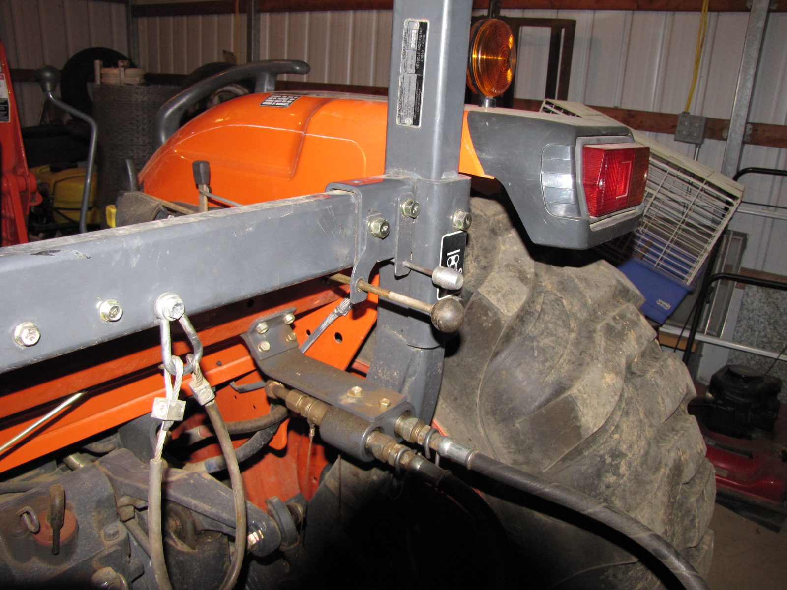

I made a setup like this for my 3pt and top link.
