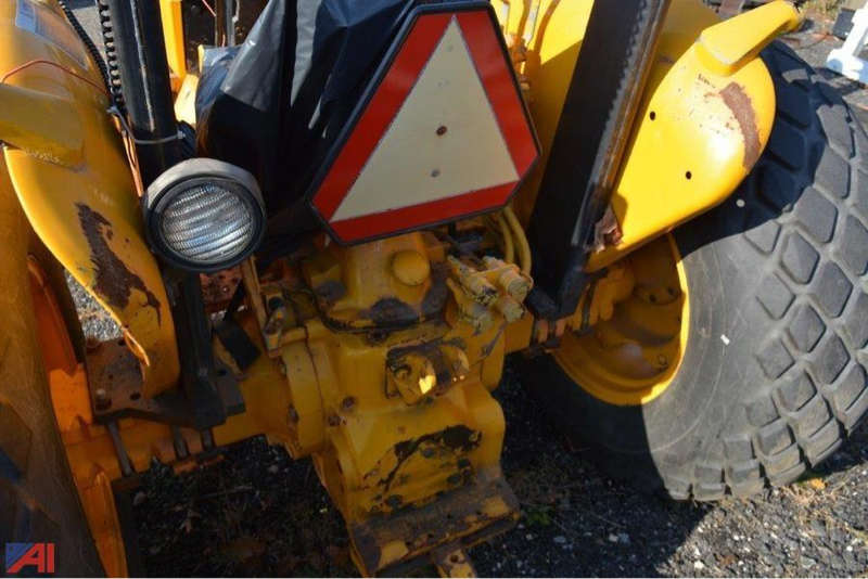

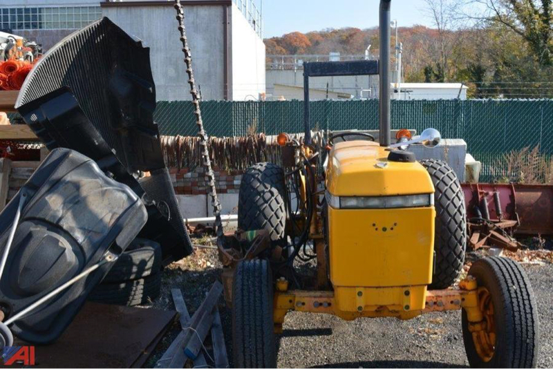

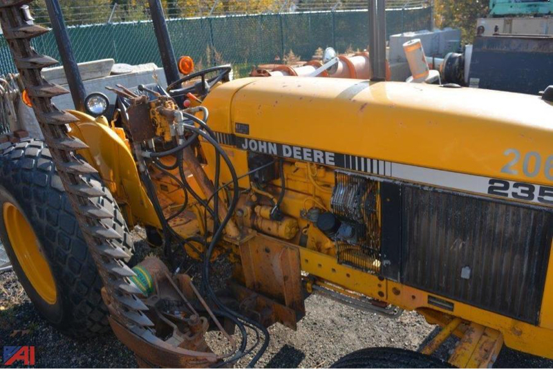

Ey guys, I think I know the answer to this but would like confirmation from those of you with much more experience than I. I have a JD2355 near me that me local town is auctioning off. It has only 1400 hrs and looks in good condition. The rear has no PTO or a 3pt. Can this be outfitted with one is my question? I don't believe it can without a major overhaul and removal of the entire rear and transmission. But I will wait to see what others with much more experience say. I already have a JD 4300 with FEL and 3pt so it is not a must have but would be nice to have a backup. I don't want to waste mine or the towns time in making an appointment to inspect the machine if it's not a worthwhile purchase. I am looking for a sickle bar mower to take care of some pond banks and under some low hanging trees, which this machine has. And it's currently priced below the price for a new sickle bar mower. Here are some pics of the machine. Let me know what ya think. Thanks.

The rockshaft and three point hitch is a simple bolt on from just about any utility tractor.
Check the free parts book on the JD web site for what pto components exist. Is there a hydraulic reverser on the tractor?
The mower is hydraulically driven?
Where is the oil returned into the tractor after if flows through the loads supplied from the jerry rigged valves on the starboard side.

Tractors that do not have pto's and three points are typically priced very very low because that is all they are worth. You could probably swing a 3 point arrangement for relatively cheap but to do a pto you will be better served to find a tractor that already has it. If you decide to get it just as a mower tractor also keep in mind that it may be just as difficult to sell later on as many purchasers will want the same features that you are looking for. Good luck

The parts book lists different quill kits for with and without pto which appear to be replacements for the flat back pto shaft cover??? The TSS transmission has kits for with and without quill's too.

There is an inspection cover for the clutch that takes 5 seconds to remove. ay as well check if there is a two stage clutch in there? I'll bet a beer there are pto shafts in there as there is no "pto delete" mentioned around the transmission hydraulic pump that also the live pto drive.
May just need the rear quill and the transmission top cover with the hydraulic engagement ???
