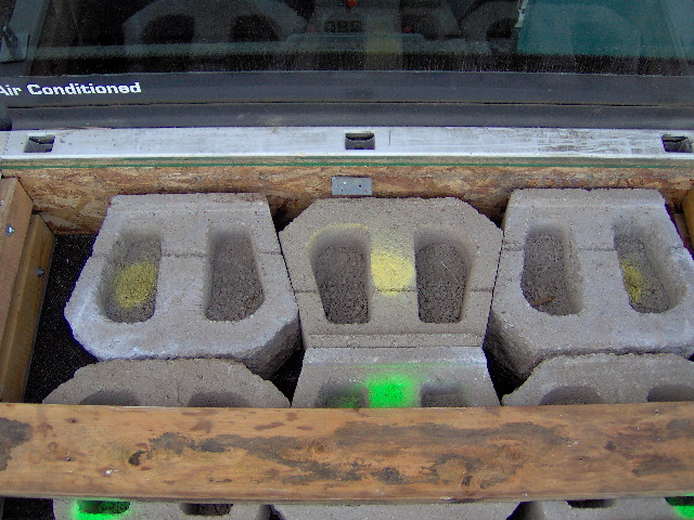

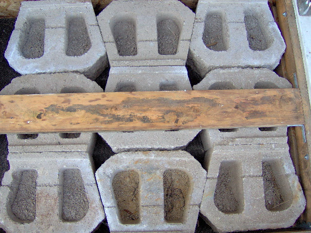

I fitted nine of these landscape blocks into the back of my TC with room to spare at the end of the bed. The blocks are resting on a "stall pad" and you can see the 2x4's stove-bolted to the sides of the bed. (The sides of the bed are pre-punched with square holes.) I have a hinged OSB panel that fits over the top to keep the snow and ice from getting among the blocks. These blocks weigh about 67 pounds apiece. The blocks are color and position coded so I can repack them. The blocks and stall pad can easily be removed for the other 6-9 months. I keep the 2x4's in place at all times just to protect the bed sides.
