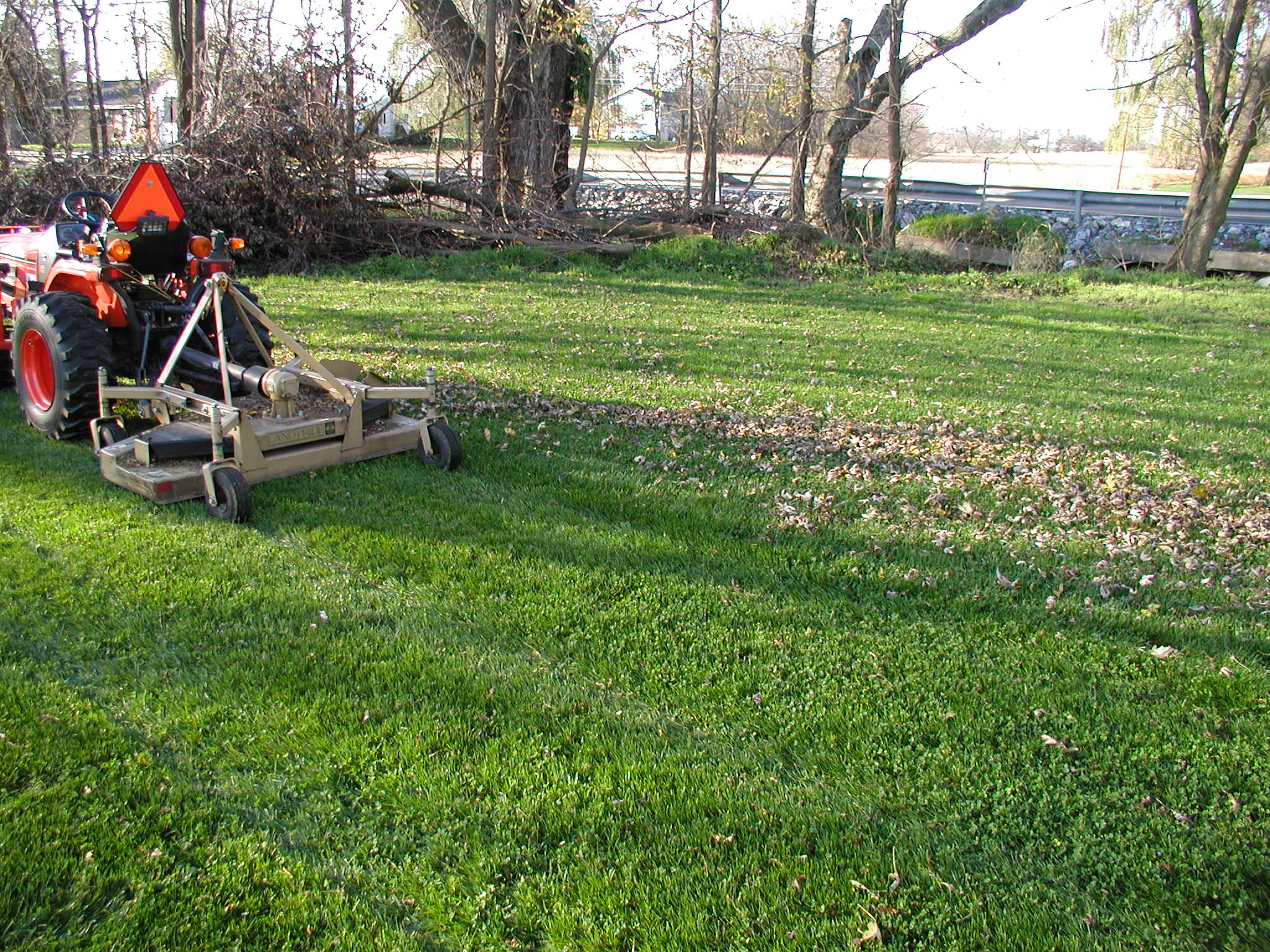

The grass appears to be too long and wet in that video for the deck to do a decent job. Either that or the mower isn't satisfactory. Here's a picture of the 5 foot Landpride deck on the B7500 I had while mowing and blowing the leaves off the yard. I'm happy with this performance.
