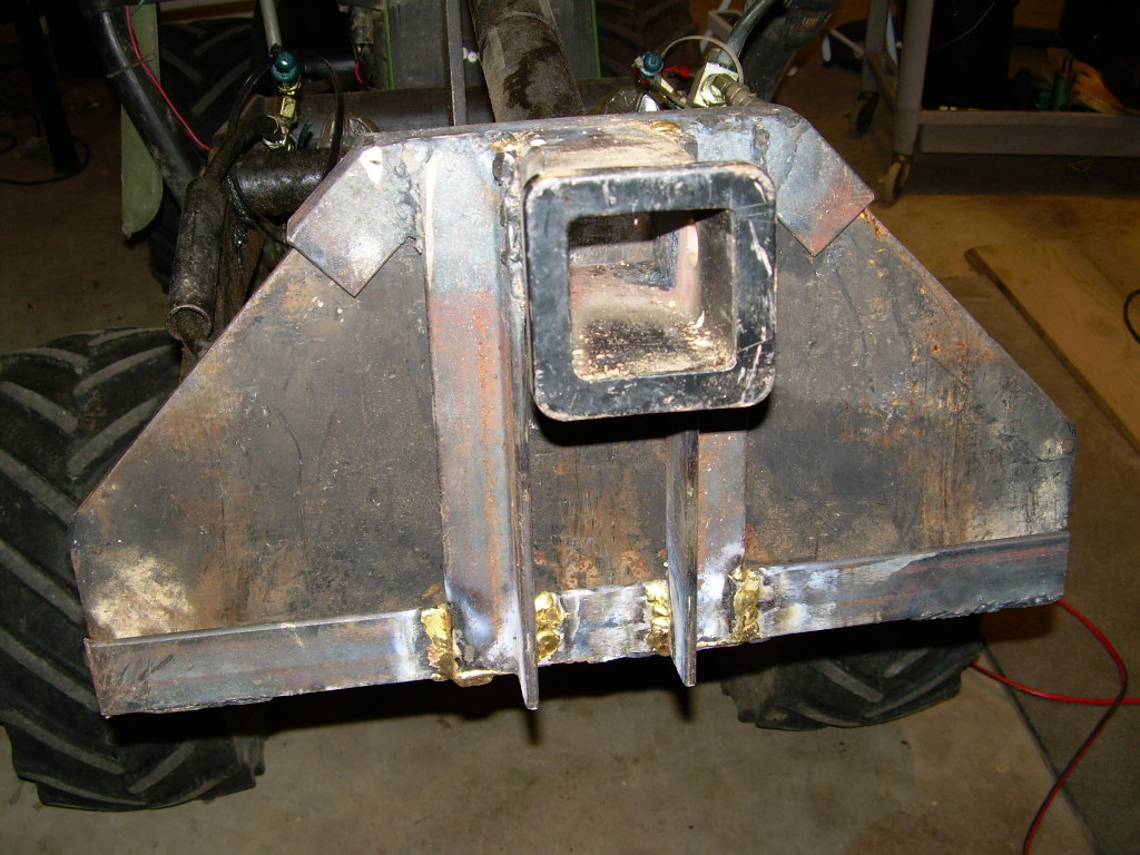

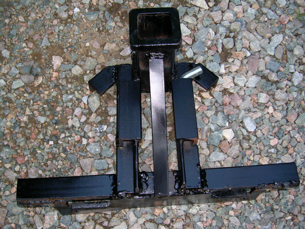

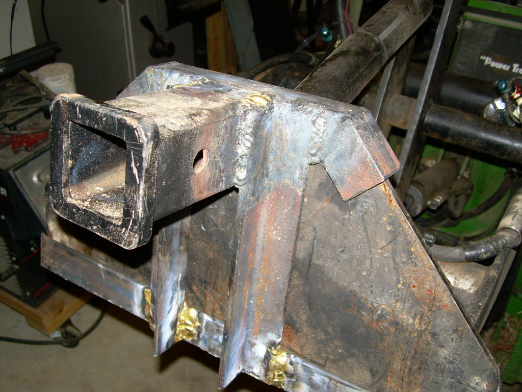

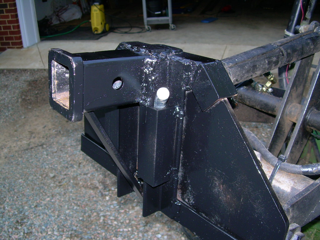

Hello All,
Here is my first attempt at making some home made
custom attachments.
   / Qa plate mod #2
Does it work the way you wanted it to? if so ya got the bug now!:D
   / Qa plate mod
Yes it does, it looks a bit jumbled in the pics. I used receiver tubes
and welded them to the qa plate. Each attachment can be used seperatly.
Boom, forks, 2"& 2 5/16" ball and soil knife. Now I'm working on flight.

can you post a slightly larger picture?
Receiver on the quick attach seems like a good idea.

I'll see if I can get bigger pics. I had to have my son help
me load the first pics. I do have a back stop for this setup.
It is made of lighter weight square tubing that also will hold a
small roll of wire. You might try to add weightto the back of
your PT. Terry at PT told me that you could add up to 500#
I don't think I would add that much but that is what he told
me. I love this machine. I haven't any major problems so far.
I have about 170 hrs. on my PT.
