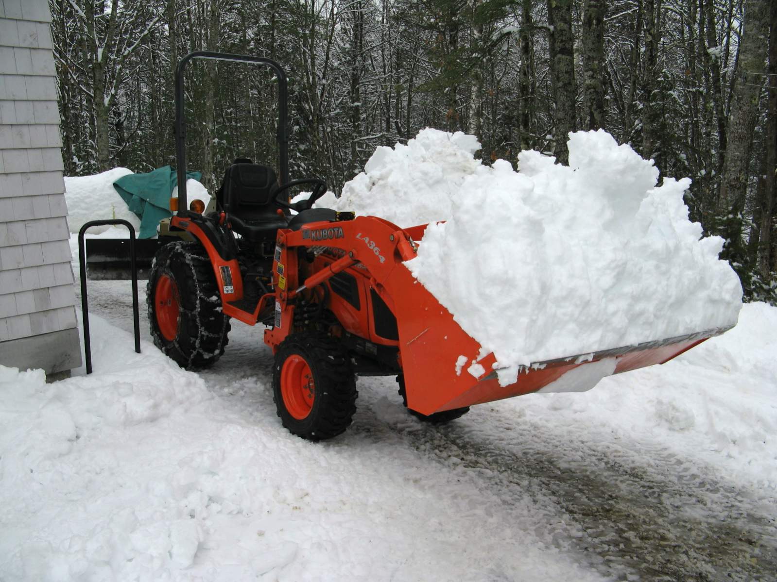

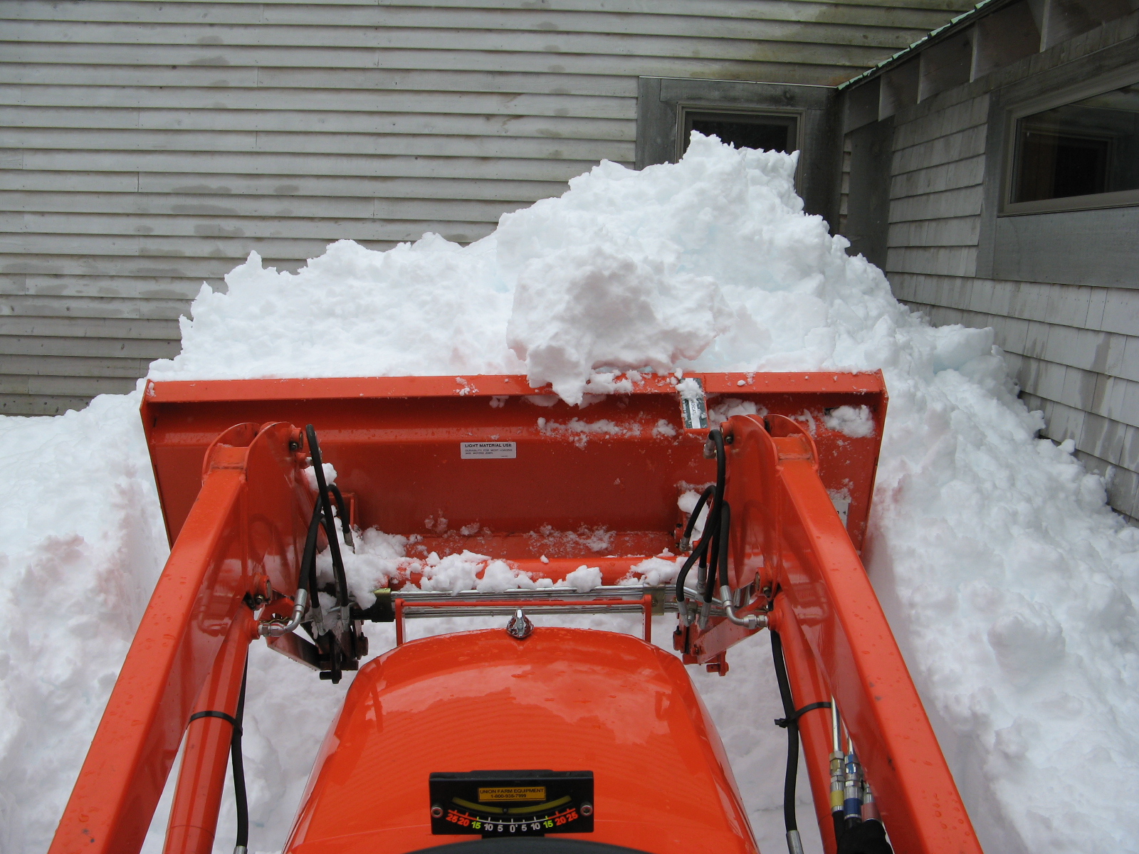

I've got the same QA on a smaller tractor and loader (B2620, 364 loader) and have not noticed any difference since I got it. In fact I even got the larger 60" bucket for light materials but have been picking up heavy,wet snow with it heaped. Another member on here with a b2620 has the QA and forks and in fact says he can now pick up even more weight with the forks than he could with just the original mounted 50" bucket. So with your b3200 and 504 loader you should have no problem, it's an insignificant difference.
