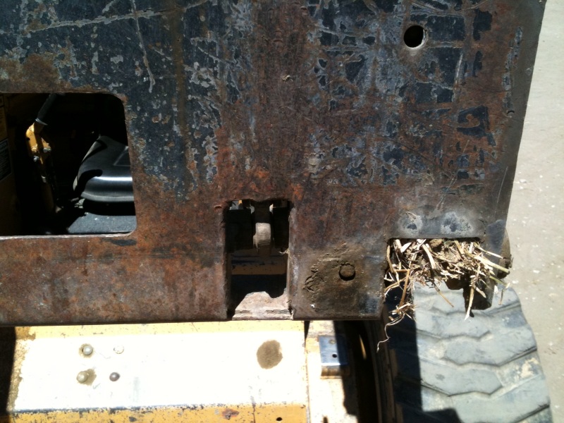

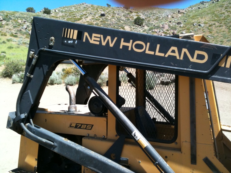

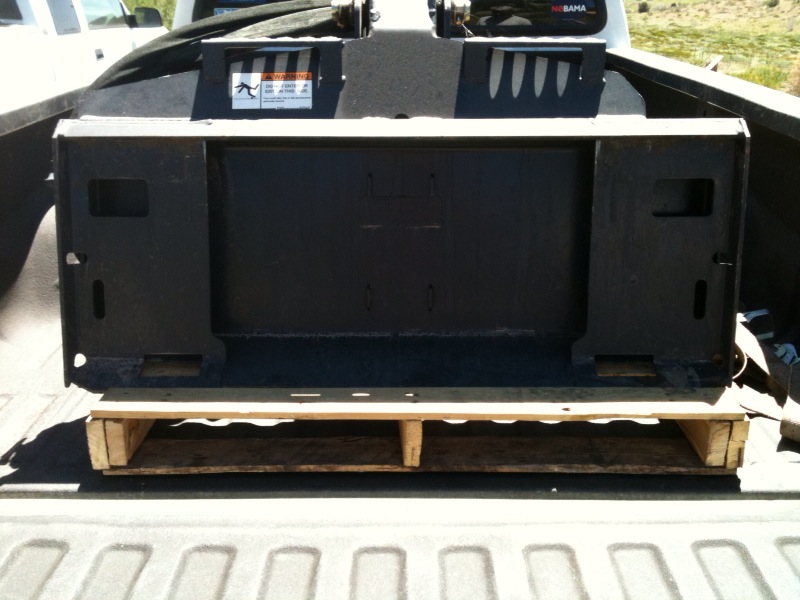

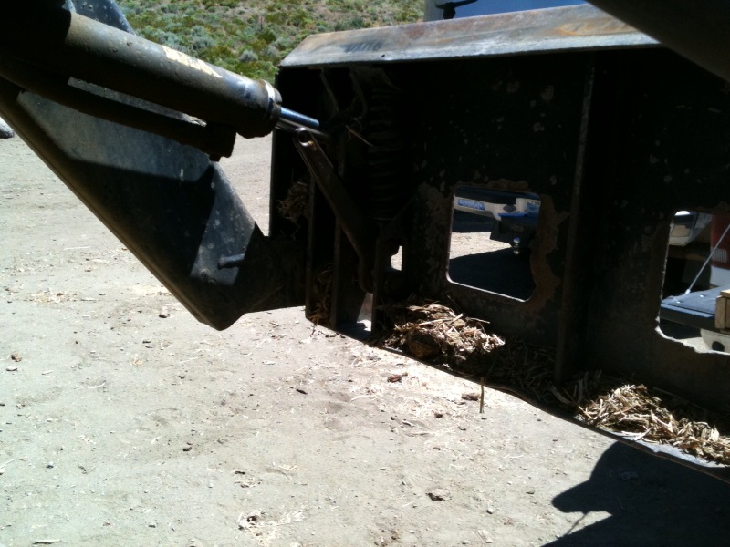

My neighbor called me over Sunday to look at his newest prize and get my help on how to adapt it to his New Holland skid steer. The prize is a near new Bobcat post hole digger, the problem is it needs an adapter to attach to the skid steer.
I have included some pictures of both and would appreciate some input.
- Does any one make a adapter?
- Is it better to make my own ? If so how heavy does it need to be ( a lot of force / torque on this area ) ?

i had the same problem with my skid steer. I have a New holland l785 skid steer which is the old style quicktach. i bought a new quicktach plate for it so that it is the modern version so that i could hook the skid steer up to any attchment.i bought it here Washburn Company & hayspear.com Skidsteer quick attach adapter fits NH 785 & others New holland sells there own version of this plate but they want over $2500 so i bought the after-market version
I would recomend upgrading the plate on the skid steer so that if you ever need any other attchment for the machine you could rent it for the day (or trade a case of beer, how i like to do it:thumbsup:)
   / QA adaptor
That is a great idea, but I think he justs wants to adapt to the post hole digger. Other wise he would have to start over with all his attachments.
